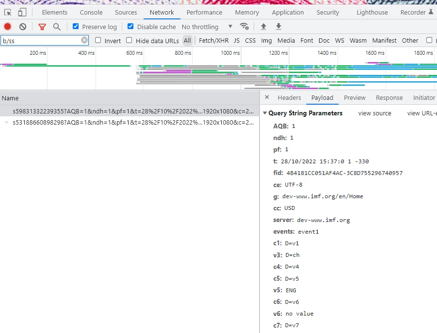

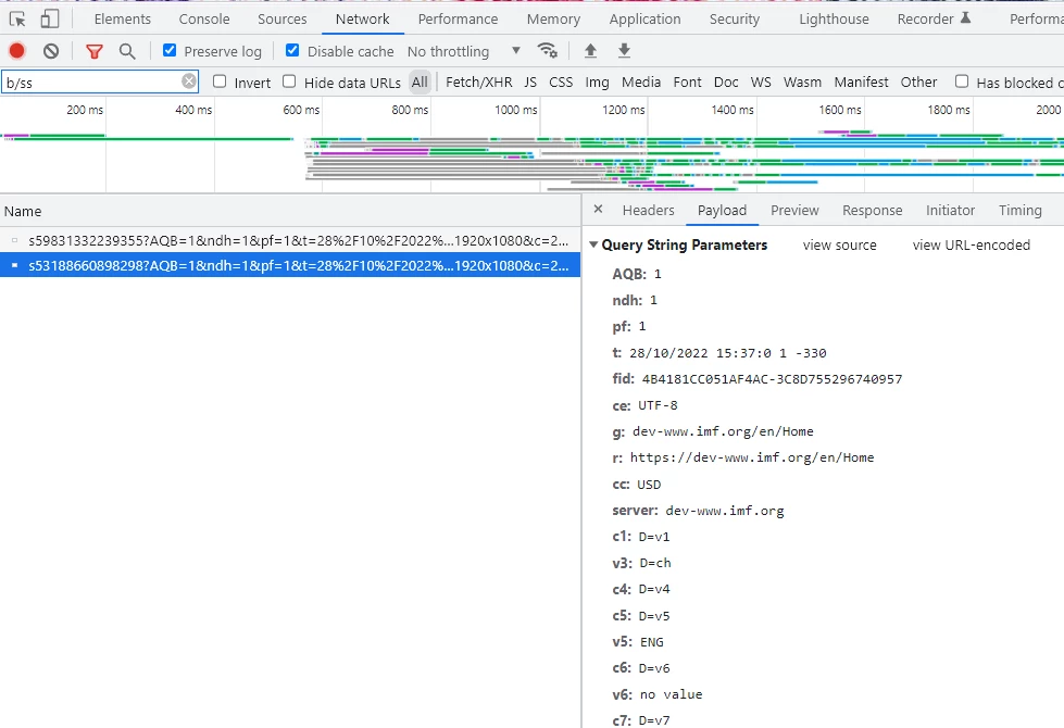

Hello Adobe,
I may not be looking it at right place, but when I load my page, it triggers two server calls with same information. One call appears from Rule as it shows pageview event1 but the other call has similar information except event1.
The only difference between calls are event1. The other one has started showing up from last week.
Can someone tell me what could be the possible issue?

Please do the debuggin in debug mode on and see if two rules are getting triggered.
MK2886Author
December 6, 2022
Thank you Ravi,
With your suggestion I was able to identify the rule that was firing additionally and just stopped sending Beacon and removed Set Variables.
