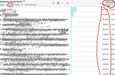

Traffic of marketing channel detail (under visit segment) is smaller than sum of each traffic under marketing channel detail
Hi, someone who consider this question.
I've noticed that the total traffic reported for a marketing channel detail is less than the sum of each individual campaign ID (cid)'s traffic within that marketing channel detail. I suspect that this might be due to the way the marketing channel detail segments traffic, possibly by removing duplicate visitors. Could someone provide a more technical explanation for this discrepancy?
Many thanks
No, the total in dark red should be less than the sum of each of the CID the rows in red.
Because as I showed in my first example, a Marketing channel that spans across multiple visits will count in both the row (value x set in Visit 1 and carried forward to visit 2 - will count as 2) and the total visits (2 actual visits have value x, will also count for 2, since there were 2 actual visits involved)...
But a visit may have multiple marketing channels in the same visit... that will count in each row below, but only count once in the total (visit 3 comes from search, then marketing email, then the user does a search - each of these will count once per row all within the same visit, but since there is only a single visit, so the total will count only 1 due to de-duplicated visits).
The last thing you want is your report to inflate the total visits.
If you have only 3 visits, and 5 marketing channels in play, you wouldn't show the total of "5"... this would inflate the actual number of visits.... the marketing channels that affect the same visit will still have to show the individual marketing channel contribution, but the total will de-duplicate to make sure the total lines up with your actual visits.

Thank your for reply, @Jennifer_Dungan.
What I wanted to say is that the sum of the Marketing Channel Detail sub CID is not the same as the traffic value of the Marketing Channel Detail.
In common sense, shouldn't the marketing channel detail traffic, which is the upper segmentation, be equal to the sum of the traffic by each CID, which is the lower segment?
There is a question.
I have noticed the case when the sum of traffic for each CID is larger than Total Marketing Channel Detail Traffic.
Many thanks
What metric are you using there?
If it's something like Visit or Unique Visitor, then that is expected, since you can have multiple Channels per visit or per User, and the total will de-duplicate.

If you came from the GA world, GA treated every campaign as a new Visit (despite being within the same "timeout" for a session)... Adobe doesn't do that, Adobe will show all the Channels that are interacted with within the same visit, so if you are using custom attribution, you can look at a participation for a visit, or for a a longer view like 30 days, etc.
Based on your behaviour, I am guessing you are looking at Visits, and summing the values is expected to be higher than the total, due to the totals properly de-duplicating.
Many thanks, @Jennifer_Dungan
This is the case of summing visits, and your guess is correct.

Thank you for reply, @Jennifer_Dungan
Now, it is clear about above example. Back to the root case, I understood that the total visit traffic for the Marketing Channel Detail (represented in dark red) should be equal to the sum of the visit traffic for each CID (shown in light red). However, the total traffic for the Marketing Channel Detail is less than the combined traffic from the 2,329 CID rows.
Are there any additional logical steps needed to resolve this issue?
Thanks a lot.
