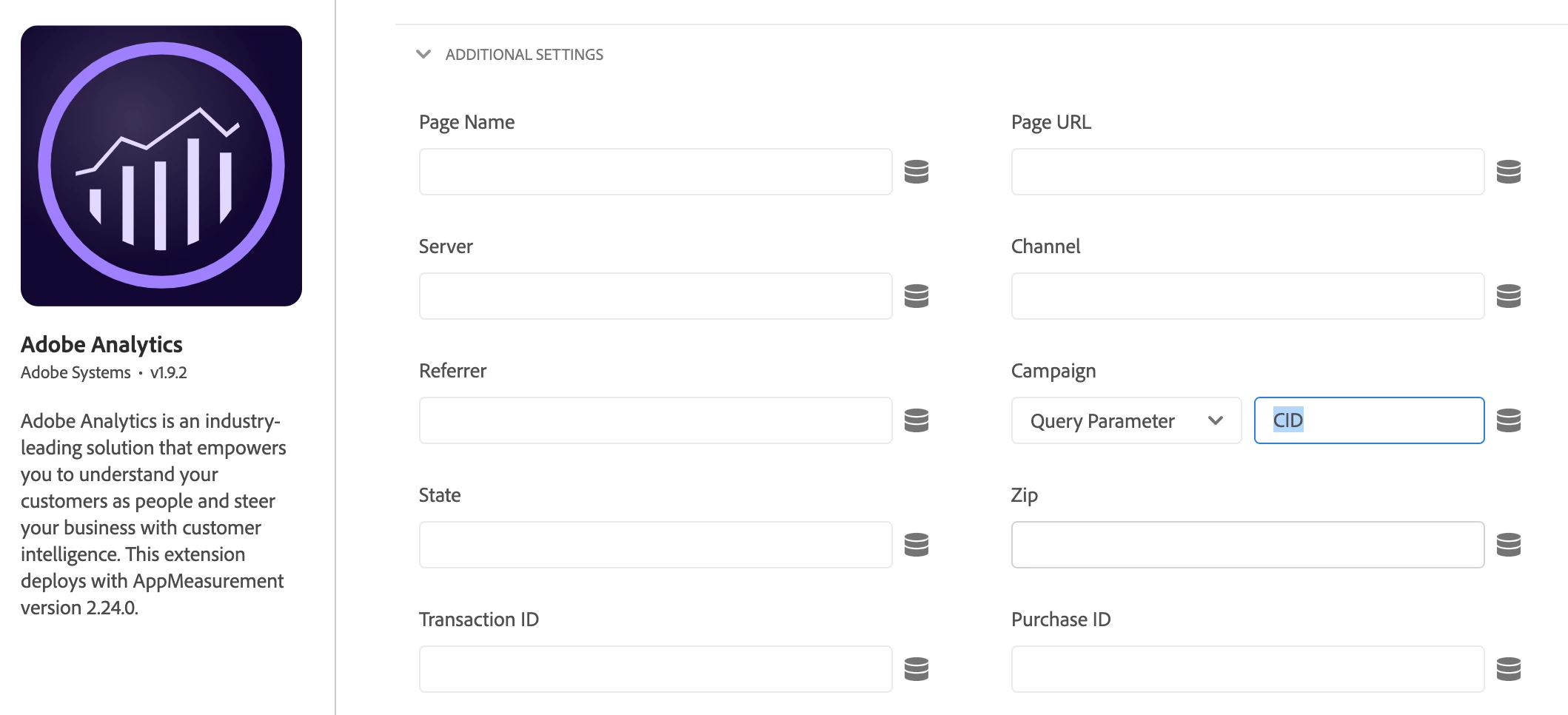

Assuming that you're using AEP Tags as your tag manager and are also using the Adobe Analytics extension there, then in the extension's configuration, under its Global Variables > Additional Settings section, ensure that the "Campaign" field has been set with "Query Parameter" and the value "CID". Ensure that you're using all-caps "CID", not lowercase "cid", because this value is case-sensitive.

Thank you for the response. We are using Adobe Launch as Tag Manager.
Here you go:-
1) Data Element Name: cidcode
                                       core >  Query String Parameter > cid  (case insensitive option checked)
2) Rule Name: All Pages - Page Load Event
    Action Type: Set Variables > Additional Settings
                          Campaign >
                          Value = %cidcode%
My question is - if we are loading any page without cid=value so the data could be stored under unspecified for tracking code / eVar0?
