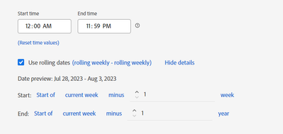

For example, when I set my panel to "Last Week" and use the "This week last year to this date range", I get "July 28, 2023-Aug 3rd, 2023", and yeah, I am not liking that (since it's not running with my "Sunday to Saturday" week....
So if I edit it, I get this definition (which looks completely wrong.. something might be up with the auto-calculated dates again... not the first time):
So I would ideally like to get a Sun-Sat, so I will change the definition to:
This looks a lot better.... now, if your weeks are Mon-Sun, this should probably work for you... If not, play with the definition until you are happy..

Thanks @jennifer_dungan my week runs from Mon-Sun, it works when manually editing it but thought it can work with auto dates.

The auto dates should work, you're right.. but based on what I am seeing, it looks like they are having issues again...
If you see my screenshot, "start of current week minus 1 week" is definitely not correct to get last year.... lol. I've seen that before and they fixed it... I think it's time for a ticket.
But, luckily you can create manual fixes when required... it's an extra step, but it means you aren't stuck.
