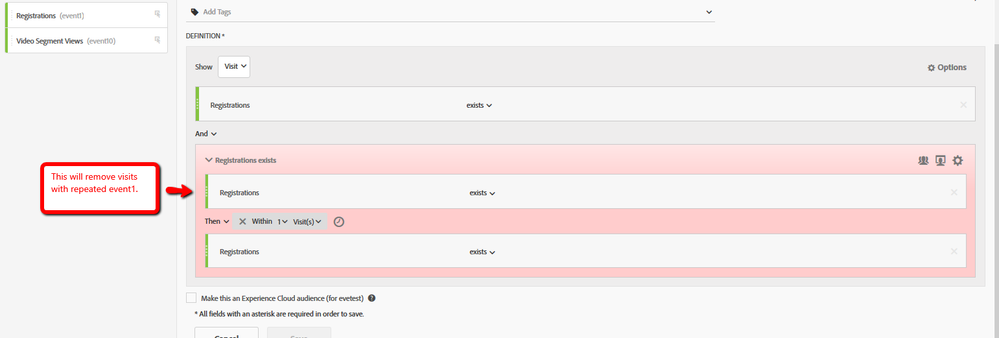

Hi Sebastian,
How about trying something like below. See if this helps.
Kanika

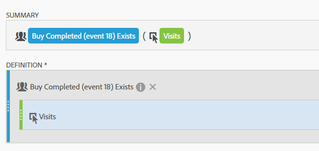

I would first create a visitor container segment with buy completed event, as follows:
After that use this segment to create calculated metrics for Buy Completed(event 18) Once per visit, as follows
This will show you exactly the same numbers as the Once per Visit Success Event. the difference will show who bought more than one policy in a visit.

Hi Sebastian,
Kanika

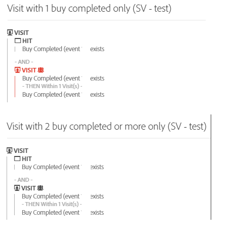

I did build 2 segments: 1 Policy bought V/S 2 or more policies bought.
... which give me exactly what I was looking for.

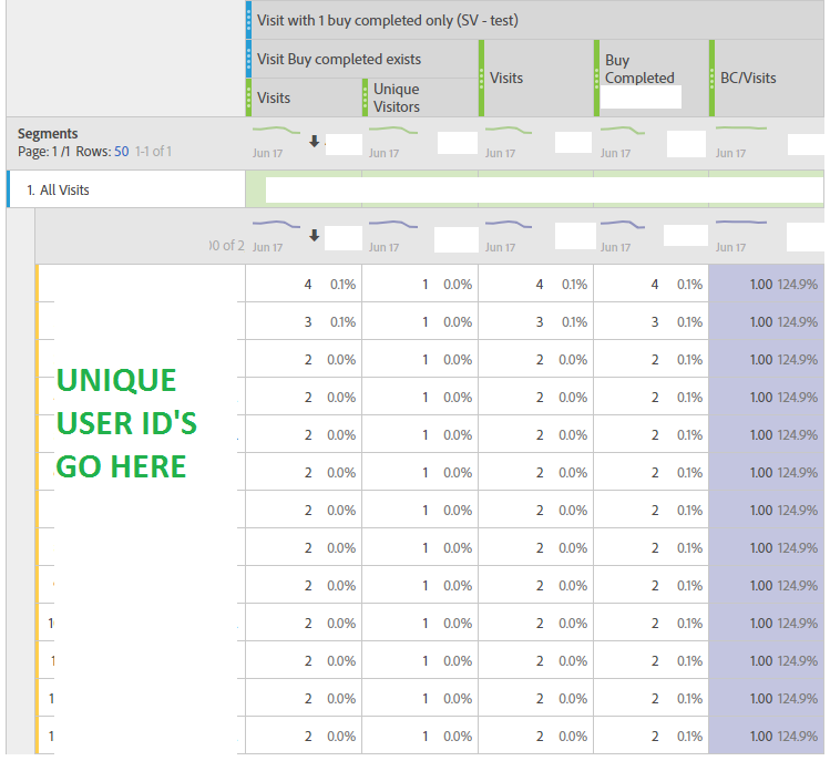

(1st segment) reports 1 buy completed per visit
(2nd segment) reports 2 or more, I see a lot of 2's followed by a small sample of 3, 4, 5 and so on.
... I'm yet to optimize the segment for only-3 only-4 etc, but will post if I solve it.
see below the Segments Logic & proof table.

Sample with 1 policy bought per Visit.
