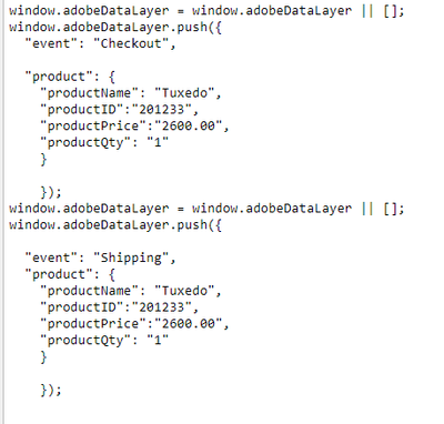

I have framed 2 rules scCheckout & Shipping in a single page with separate data layer for both the specific events as shown below. I have created separate XDM data elements also for the same. But i am not able to view the network call for the shipping rule i have configure.

I suspect that it's a timing issue. Your 2 data layer pushes are occurring one after the other immediately. But during the "Shipping" push, the browser is still processing the "Checkout" push. As a result, it seems that the "Shipping" push is not being triggered.
From what I can see in your data layer contents, you're sending the same product information both times. So no one can really tell if it is the "Checkout" or "Shipping" push that's actually being tracked, we can only assume that the "Checkout" one is being tracked since it comes first. To verify, can you modify the productName for the "Shipping" push to be something different? Then we can see which data layer push gets tracked: the "Checkout" productName or the "Shipping" productName.

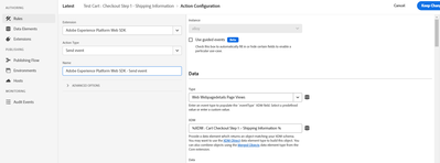

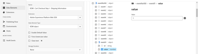

Hey @yuhuisg, kindly refer the S.S below.

2.1) XDM Data Element created for Cart Checkout Step 1: Shipping Information.
2.2) Rule Created for Shipping :-

Thanks for the screenshots. Looks like your Rules have been configured correctly.
Hey @yuhuisg , ok let me try giving a different product detail for the data layer with respect to shipping XDM Data Element i have framed.
