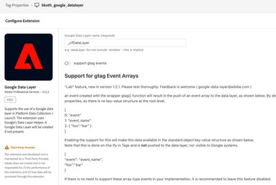

I have a question on the datalayer as our site has two datalayers (dataLayer and _CfDataLayer). When we set up the Google Data Layer extension, we set the data layer name to be _cfDataLayer as our most up-to-date data push, while we clean up the default dataLayer at the moment.
However,despite the configuration in Adobe Data Collection to use updates made to _cfDataLayer, Adobe Data Collection seems to pick up the old default dataLayer and respond to updates made to it as opposed to _cfDataLayer. Is there anyway that we can configure this to pick up the designated datalayer name?

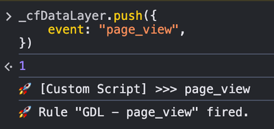

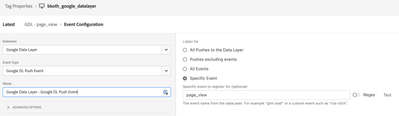

Hi @Xingu13
works fine for me.

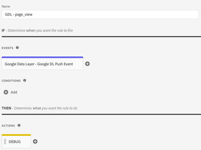

My setup
Rule: "GDL - page_view"
with a debug action
_satellite.logger.debug(">>> page_view");
And on my test page, I push a page_view event.
_cfDataLayer.push({
    event: "page_view",
Can you be more specific what does not work for you?
