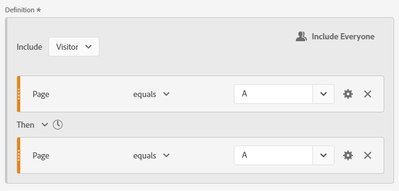

Dear JungTaejun,
Think about the sequential segment below.
The segment should provide you with the number of visitors who have seen the page at least 2 times.
Now, if you modify it marginally like below.
Then the segment should provide you with the number of visitors who have seen the page exactly 2 times.
So, play with the sequential segments and see if you can create a segment based on your wish. Just passing my thoughts here and all the best.

Dear JungTaejun,
Thank You, Pratheep Arun Raj B (Arun) | NextRow DigitalTerryn Winter Analytics

Dear JungTaejun,
Guess my second screenshot will not work for "exactly 2 times". You need to exclude at least 3 times to make the segment workable. Sorry, I was just passing my thoughts earlier and didn't validate the segmentations. Please validate while you are building the segments!
