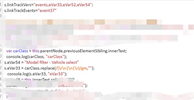

I set up a rule for page link click, when rule fired, pass the element innertext to eVar33.
I also added console.log(s.eVar33, "eVar33") to print out to make sure it has value.
However during debugging, I found that rule was fired and console log shows value for eVar33, but in Omnibug there is no eVar33.

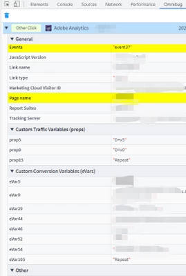

In the rule I set to send beacon to Analytics, but somehow it did not send, but in this rule I have other eVars and they are populating corrent values in Omnibug. Only missing eVar33, how strange!

1. rule setting value for eVar54 and eVar33.

3. however in Omnibug (also in report), there is no eVar33.

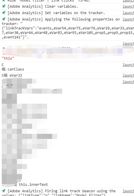

I had a breakpoint in the rule, and I found that before send beacon action, the eVars are set right values, but when send beacon was triggerred, eVar values changed! Please refer to below screenshots.
1/ When clear variables function fired, all eVars are cleared, which is correct.
2/ When linkTrackVars executed, correct values were set to eVars.
3/ But! when send beacon was executed, some eVar values changed, see eVar33 change to 'null'..I think which is why I cannot see this eVar in Omnibug.
4/ as a result, omnibug shows the latter eVar value.
Can't understand how this could happen, the behavior triggerred this rule, which is click on the link, will lead to a new page, is that maybe the reason? but still it doesn't make sense..
