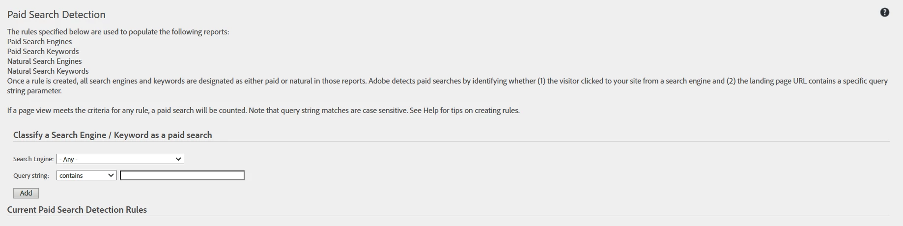

This is backed up by the fact that that "Paid Search Detection" looks at known search engines as the referrer, with the added campaign codes of a paid ad.

Both Organic and Paid Search are generally going to share the same referring domain... this is why Adobe has the Paid Search Detection settings per suite:
Adobe knows what referrers should be search engines, then you can specify what query parameters are being used on your paid search.
The referrals with the specified parameters will be grouped as "paid search", and everything else as "natural search"
If you are trying to use Crazy Egg (without access to your Adobe data), that might be a bit harder. I have never used it... and if you can only filter by referrer, you won't have enough detail to split that into Paid or Natural Search... (since it's the parameters in the URL of your first page that determines if it was paid or not....)
