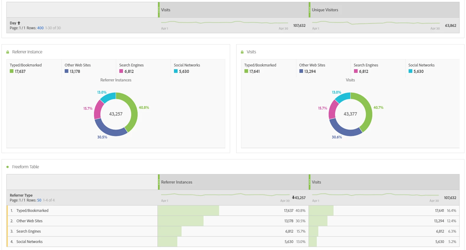

Hi
I have a query about the Referrer.
Sums of Referrer Instances and Referrer Visits is similar.
but, between site visits and referrer instances or referrer visits, there is a big gap.
is it possible to come to a site without referrer?
Thanks.
Best answer by Hyder_Ziaee
There is another entry in Referrer type that is not shown here. It is only available in Data Warehouse reports - Inside your site.
This is when the visits begin from within the site itself. Example, I go to a website and then stop browsing it. I do not close the tab. Later on, (more than 30 minutes) I start browsing the site again from the same tab. This means my visit began from inside the site.
You can find it mentioned here: Referrer Type
-Hyder
