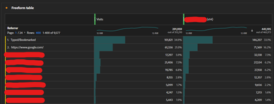

Hi Benjamin,
the reporting I look at in Workspace is very similar to the one in your screenshot. So basically just looking at Metrics broken down by the Referrer. Here is an example:
In general it does not matter what Metric i am looking at or how it behaves, my question is more about the Referrer Dimension in general.
Regarding the Data Feed: We have a data feed set up with all relevant columns on a hit level from the same report suite. Bot Traffic is of course excluded in both the Data Feed and Workspace data, so that can not be the reason for this discrepancy.
When looking at the aggregation of those Metrics (Visits, Custom Event 14 etc.) in the Data Feed and group it by the referrer or post_referrer or ref_type (or pretty much any column that is based around the Referrer Dimension) columns the numbers are vastly different to what i see in the Screenshot above for example. So I am just kind of looking for a way to get the same numbers from our Data Feed as i see in the Workspace Report if that makes sense 🙂
I hope this helps and gives a bit more context.
