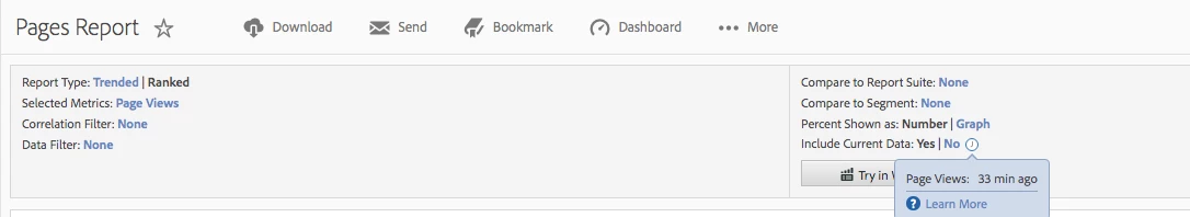

The closest you could try is create a custom report and depending on metric see how close to real time it will be. Include current Data needs to be selected.
In most cases looking around a 10 to 40 mins delay, so users could refresh every few mins to see if they get enough info.
