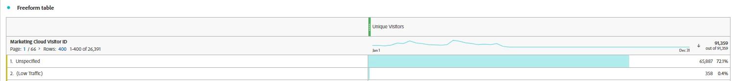

Hi all, I need help with this issue that I am facing for my adobe analytics report.
Based on the screenshot attached, only ~30k ECIDs were captured in the report suite.
For the ECID, I used an extension called Experience Cloud ID Service to capture these values.
What does it mean when there are unspecified values in the report suite for ECID values? Could this be a configuration issue?

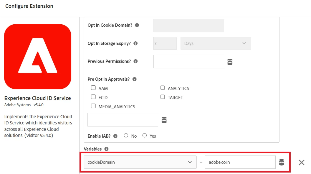

Dear @raudhah ,
Often the main culprit would be the 'cookie domain'. Check whether the cookie domain value is set properly in Experience Cloud ID Service Extension with 'Opt-In' disabled (Are you using Opt-in functionality?).
Or, if possible, kindly share the public URL, we will validate and revert you.
Thank You, Pratheep Arun Raj B (Arun) | NextRow DigitalTerryn Winter Analytics

Hi Arun,
The 'Opt-in' function is disabled.
Currently, there is no variables declared under this extension set up.
If I were to update with these values below, will the issue be resolved?
Also, do you know why the adobe analytics report is able to capture the ~30k ECIDs mentioned above?
