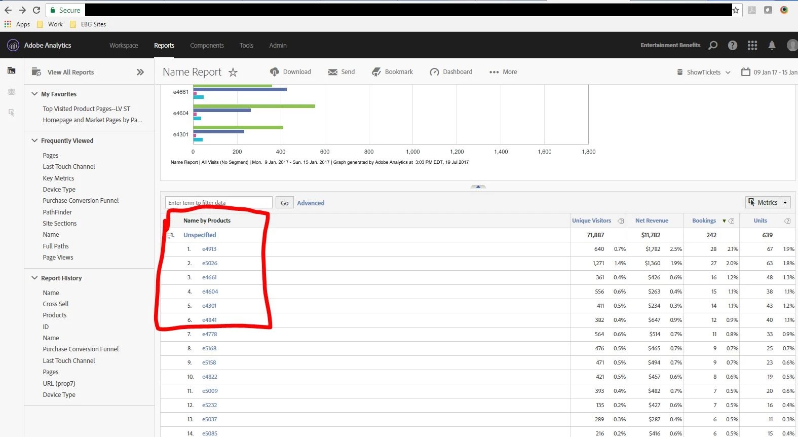

Hi Analytics Community!
I was wondering if someone could help me with my product name report. I am getting a lot of product IDs that aren't populating their product names. I'm thinking it has something to do with the s.productName variable not pulling any data, however it might be that we do not have product names assigned so that the variable can pull from it.
I've attached the screenshot here. Any help is greatly appreciated.

May I know what the Name report is? Is it a classification of Products report? If so, it maybe the data is not classified (yet).

Hi hyderziaee​, Thanks for responding!
That's correct, it's a classification of the products report. It would be great if you could show me how that can be done.
if I click into the unspecified products, I can see their product IDs. Hope this helps clarify. Thanks!

Tom,
You may want to check who in your team is classifying the rest of the product names.
You can also do it by going to Admin > Classification Importer > Import File
Here are some links that will be helpful:
