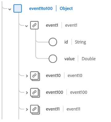

I have a question about how to send the eVars and events in my application. While I've successfully been receiving the eVars in Adobe Analytics, I haven't been able to track any success events in AA. Please refer to the attached screenshot of my current configuration for reference.
Do you have any solutions for this issue?

I am not on WebSDK yet, but I was digging through some documentation and I am not sure, but the examples I saw looked like their was additional keys under each event
https://experienceleague.adobe.com/docs/experience-platform/xdm/field-groups/event/analytics-full-extension.html?lang=en
So maybe you need to pass the id and value?

Hi Jennifer,
You were right; that was indeed the problem. Once we made the change in our schema in the source code, I started receiving the data.
Thank you very much.
