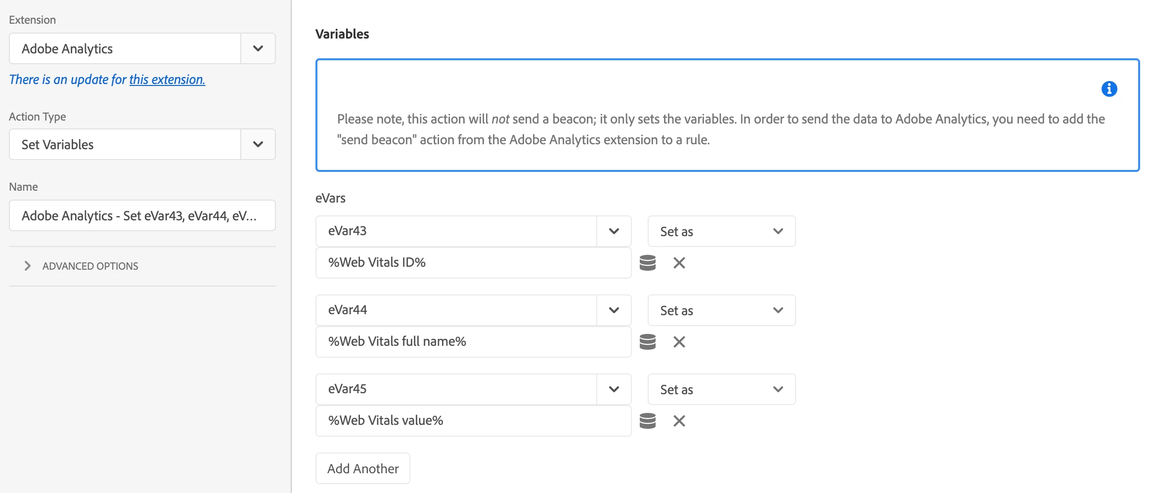

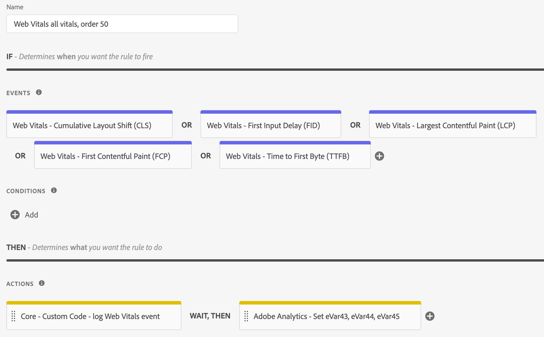

Here are screenshots of an example rule that sets eVar43, eVar44 and eVar45 using the Web Vitals data:

Yes, it is still working. Did you try my solution in the reply marked as "Accepted Solution" here? If it's not working, please provide more details of your setup. Screenshots of your Rule's setup (including screenshots of the event, condition and action components) would be very helpful too.
If you have a Rule that uses the "Cumulative Layout Shift (CLS)" event from my extension, then the metrics data elements will have the data that Web Vitals had returned for that measurement, including delta. You can certainly track a metric as a (numeric) event, if desired.
