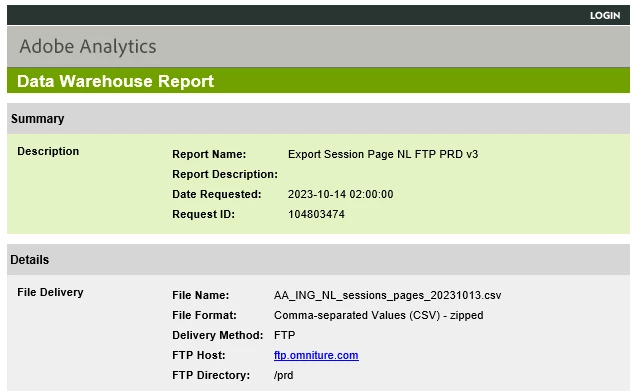

I have some scheduled exports defined to run each morning at 2AM about data of the previous day.
I noticed that sometimes the export is incomplete and sometimes it's ok.

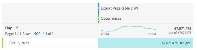

To validate this, I scheduled (at the same time as the DWH export) a report to be sent  on the segment containing the data to extract.
So without any modification, the result can change by day.
EX :
report send on the 14/10 (so about data of the previous day)
Segment definition:
The export about this day:

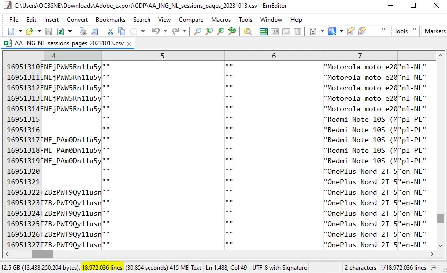

and the number of lines in the file:
So some day it's ok and some day not ....

In my export I don't request any metric to be present and one dimension used ensures unicity of the data, so no issue (theorically) with duplication.
That's the reason why I used occurences in my report.
But as said, majority of time, it's aligned but in some cases there is a huge difference between the report and the export.

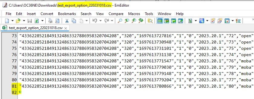

I try play with the following options in the new interface:
As result I have this:
with details:
but the number of lines announced in not in line with the file itself:
So I'm a bit lost ...

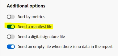

I think I found it.
With only using this option in the export:
So without the digital signature file, the info looks OK :
And with this now it seems ok:
and it's aligned with the quantities of the file (without the header):
So it seems OK

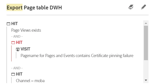

One thing to notice that, The Excluded bucket will not be working in Data Whareshouse. So, Please try to create the segment with out exclude and try.

Excluding the session make it not compatible with DWH but I found a workaround:
in place of excluding the session directly, I exclude all hits of the session I want to exclude:
I compare result in the workspace inteface by creating 2 segments:
- excluding a visit
- excluding all hits of a visit
And it gives the same result.

Yeah, I would expect if any part didn't work with Data Warehouse, the compatibility would reflect that...  this looks fine to me.
