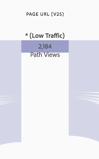

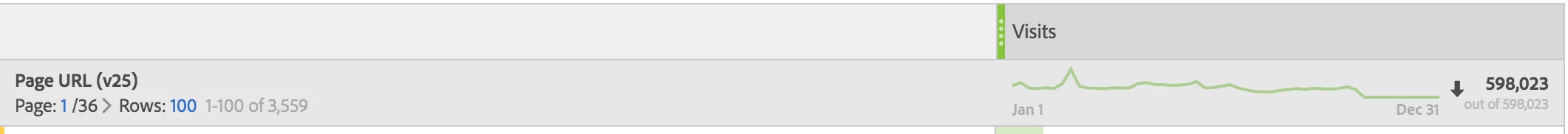

The flow in Workspace for some reason I can't understand it is only accounting for less than 0,5% of the total visits of a filtered segment. Using Page URL, Journey Pathing or Page dimensions just goes from 500K visits to 2K.
See here how many visits we have in a segment for one year:Screen Shot 2019-10-25 at 12.30.45 PM.png
This is what I see in the flow diagram using Page URL (v25): Screen Shot 2019-10-25 at 12.32.02 PM.png
Same happens when using "Page" or "Journey Path".
