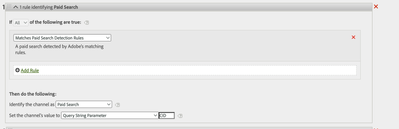

Hi, I am fixing my marketing channel processing rules. Can I use multiple values like below screen shot or do I have to add separate rules for each of the strings to match?
@jennifer_dungan Makes sense to me. But If I try to put different values in a list format in a rule then its by default is "ALL" operator instead "Any" and for one rule it doesn't allow you to choose "Any"...
In my previous response where I shared a screenshot for paid social, you saw a list of values with "Any" operator. It came for me when I clicked ADD New rule and removed it. That way I selected "Any"
So I want to confirm from this ASK is if I put values as list in rule and keep "ALL" then my condition will work or not?
The "All" and "Any" in that initial drop down reflects the rules/boxes/blocks in the rule set (the ones that you can remove with the x, or add with "Add rule"):
In this case, in order to be identified as "Paid Search" the channel must BOTH match the "paid search detection rules" AND the "cid" must start with "pad" or "med".
If you change it to "ANY" at this point, then it need to match either (or both, its not an exclusive or) "Paid Search Detection" OR "cid starts with one of the listed items"
This list block is always going to be an "OR" list, no matter what is selected in the All/Any dropdown:
I don't know why you are saying this can only be an "ALL" rules... you should see "ANY" in the dropdown, if you have more than 1 rule in your rule set.....
Unless you removed the "matches paid search detection rules" like so:
But still, the ANY/ALL refers to the blocks, not to the list items... the list would be useless in 99% of cases if it was processed as an "AND"... IF you need something to "contain X and Y" then you would make sure you have "ALL" selected, and create 2 rules:
cid contains "X"
cid contains "Y"
cause you need BOTH to be true... and they are not mutually exclusive.

That should work.. the rule specifies "Any Of" which means it should look for cid to start with any of the listed options.
Are you getting strange results? Or is this just very new and you are just looking for a second opinion before it runs for a while?
For what it's worth, this looks absolutely correct to me.

Hey @jennifer_dungan  its all new cid codes for social paid that we are going to opt so looking to add it in marketing channels processing rules so that they can be bucketed in correct dimension item of Marketing channels ie. social paid. From that perspective does it looks correct? I am just confused between "All" or "Any" in rule
Because for social organic we use "All" for a list and this is advised

Sorry, I missed that you changed the order already. This looks good to me...
Or at least nothing stands out to me... once you start collecting data (if you aren't already), keep an eye on things and make sure your campaigns are being filtered as you expect 🙂
What can look good from here may still miss one or two things that couldn't be anticipated.
@jennifer_dungan  I use cid after the query string parameter in lower caps. So if I have I am using CID in caps in paid search detection rule so does it impacts
And in Processing Rules also I am using the term as CID in caps
