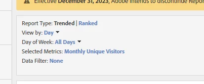

Is there any workaround now available to get Monthly Unique Visitors by day now in new workspace. I have tried various methods such as dividing unique visitors into total unique visitors etc. which gives a close enough breakdown to get it to match the monthly figure but it will not work for our upload to our MI.
With the old report we could upload daily information into our MI tool as far back as 2021 but my workarounds work on a total level not monthly. Hoping there's something we can do to get around this.

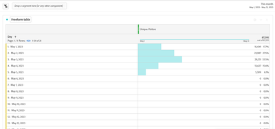

When you do the breakdown as shown by @raji4, this will show you the total UVs for the month as a total, and the UVs that came to your site on the corresponding days... the fact that the old "Monthly Unique Visitors" shows lower numbers (yes, I checked in my data), indicates more of an issue with that old metric then with using the flexible Unique Visitors.
May 5, 2023
We need to select date range month and select dimension "Day" and metric "Unique Visitors". Please check attachment:

Thanks for the response. The "Monthly Unique Visitors" as my understanding was it shows a lower number as it's unique visitors for the month.
Where the new view shows the Unique Visitors for the month removing duplicate visitors. But Unique Visitors for the day too which means your daily totals won't sum to Month total.
The logic makes sense within Adobe Analytics but for us, we are trying to add metrics to a 3rd party MI tool and Unique Visitors won't add up when we use a look back window as if we upload traffic daily the unique monthly visitors will be significantly higher on our MI tool over Adobe.
I'll go back to the drawing board!
