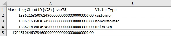

Thanks for the reply. That is what I did with method #2, yet the MIDs that returned in the data pull are NOT the MIDs that were listed in the segment (or even look like MIDs for that matter).

Also if you are trying to open these IDs in excel via open file, beware the cell field needs to be opened specially(via import menu) as it will truncate MIDs.(they are to long)

This solved the first part for me, thanks! The data is there but have to Open the csv via File, not simply open the csv.
