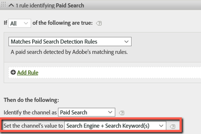

Please make sure that when you are looking at the Marketing Channel data the use Marketing Channel dimension along with the Marketing Channel Instances metric & if you need to break down Marketing Channel dimension with any other dimension then please set the dimension in the 'Set Channel's' value to' field in the Marketing Channel Processing rule user interface as shown below.
Once the Marketing Channel Processing rules are set you can break down the Marketing Channel dimension with the Marketing Channel Details dimension as shown below.
