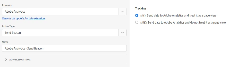

Issues with data collection in eVars
I recently created a new rule in Adobe Launch with new Data Element to retrieve data from eVars.
My data elements retrieve the required data. I was able to test their content directly in the console (see screenshot below).
I was also able to check that my rule is well triggered thanks to the debug mode.
However, I don't receive any data in the concerned eVars...
You can find below the configuration of my rule.
Rule.pngBelow is the setup of the Set Variables action:
Below is the Send Beacon action
I already double checked that my eVar are enabled in the report suites I tested.
Do you have any suggestion to investigate this and troobleshoot this ?
Thanks a lot.
Hello @VaniBhemarasetty@Pablo_Childe@Andrey_Osadchuk,
Thanks again for your advices here. I finally found a solution thanks to this post. In fact it was "just" a timing issue.
My rule was processing to soon and so my data elements weren't able to get the data when the rule was processed.
I just had to change the trigger from "Page Bottom" to "Window Loaded". It's now working.
Thanks anyway for your help!
