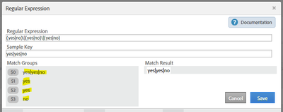

So when we created a report for Rule 3 with a custom event, the expected value should be just "yes" or "no".
The issue is, our report shows "yes", "no" and "unspecified".
When I breakdown the "unspecified" by eVar X, it will show the correct values with only "yes" or "no" values. No empty one.
hmm ok.. is it possible that there are spaces (or worse.. a non-space character that you can't see)? Or maybe a case issue... I know that Adobe Analytics tracks the data with cases... but a while ago, they did start to group the upper and lower case variants under the version first seen... but I wonder if the underlying data is actually a different case (even though you can't see it)
I assume your rules are using regex?
When I did a sample test... and I made one or more of the values in the sample Key uppercase, this is what I see:
The "Match Result" isn't highlighted in white indicating a match, and none of the "Match Groups" are there....
When I change the sample key to all lowercase, I get this:
Unfortunately, Adobe's regex rules are rather simplified, and you cannot add the "ignore case" flag.....
So I wonder if a more generic rule like (\w*)\|(\w*)\|(\w*) would work better? (though this doesn't allow for potential white space in the middle of the values if that happens to be the issue)
Notice I put the second "Yes" back to a capital, but the rule still pulls out the value.....
I am only guessing at your regex at this time.. maybe you already accounted for this.
