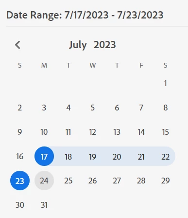

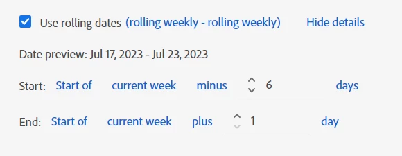

1 Week Ago (Custom Monday to Sunday)
Basically, using the "standard" week, I look at the start of this week (which would be Sunday, July 23) and subtract 6 days (to get the previous Monday - July 17th)
Then instead of using the default "End of" on my end definition, I switch it to start of current week (which is the same Sunday July 23 - midnight) and I add 1 day (to get it to include July 23).

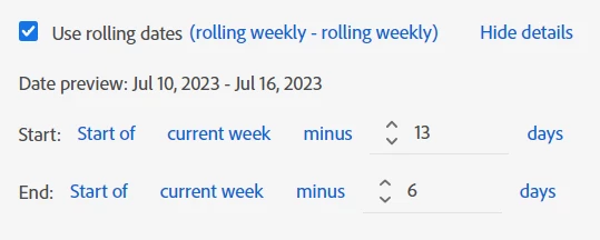

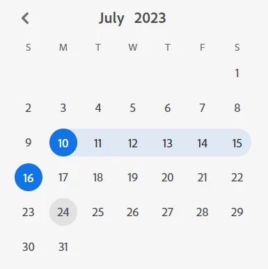

2 Weeks Ago (Custom Monday to Sunday)
Similar to above, I use:
Using the same standard week definition, I again apply my day shift...  minus 13 days for the start, and minus 6 days for the end, resulting in:
You can follow the pattern of the 2 Weeks Ago range for any other weekly range, you just need to change the number of days to shift....

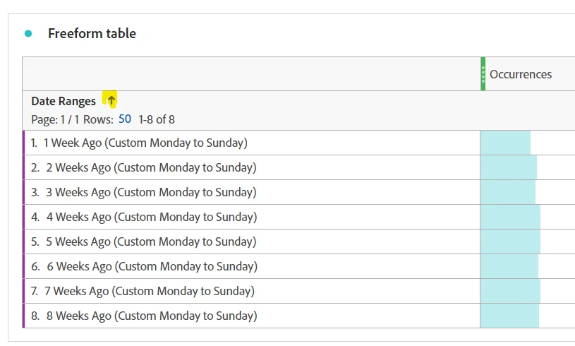

Then you can use in your freeform like so (don't forget to sort by your dates ranges - which is also why I use "1 Week Ago" instead of "Last Week" since 1, 2, 3, etc of the X Weeks Ago allows for sorting):
