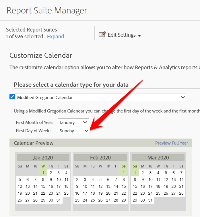

In order to change the week to start on a Sunday, you need to use "Customize Calendar" option in Analytics UI as follows:
Admin Report Suites > Select report suite > Edit Settings General Customize Calendar
There you can modify the First Day of Week - screenshot below:
Document Reference: https://docs.adobe.com/content/help/en/analytics/admin/admin-tools/custom-calendar.html
