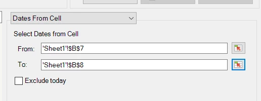

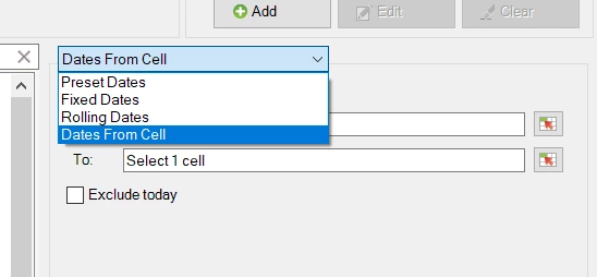

Once you have the date fields established, you can use Report Builder's "Date from Cells" option to create pulls from the selected dates, and then again from the comparative dates:
This way, your comparative dates will always be in line with your selected ones, whether the range is a matter of days, weeks or months, etc
