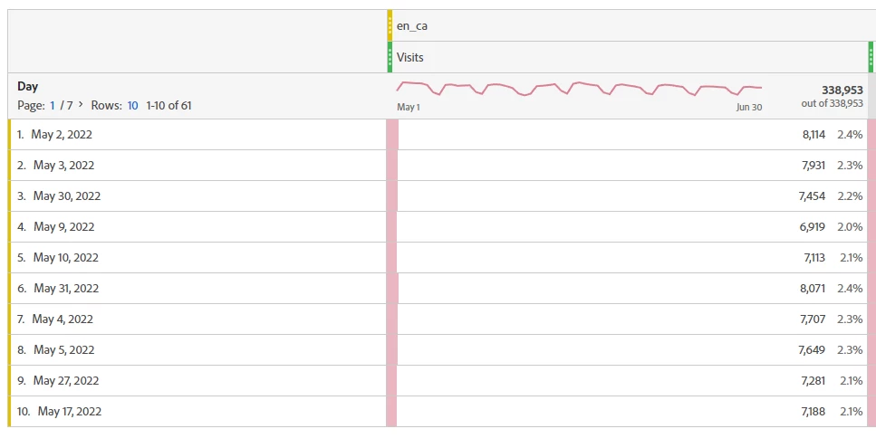

Hello Community,
I am looking to create a dashboard for our stakeholders where they wanted to see the Worst hour in a day by Visits and the Best Hour in a day by Visits as a separate columns.
I have below table which shows Visits / Day and looking to have 2 new columns which can show me the worst hour (in terms of visits) and number of visits on that hour, best hour(in terms of visits) and number of visits on that hour.
The output iam looking for can be like below, just sharing it as an example:
Visits
Best Hour
Best Hour Visits
Worst Hour
Worst Hour Visits
Day
May 2, 2022
8,114
11:00 AM
465
12:00 AM
 3
May 4, 2022
79,018
9:00 AM
1,003
4:00 AM
8
May 5, 2022
65,111
7:00 AM
5,045
5:00 AM
200
Is there any way I can get these metrics in Adobe Analytics. Any help or suggestions would be greatly appreciated.
Thank you very much!
Satish

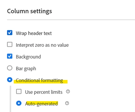

Then I would configure the Visits to be "conditional formatting"

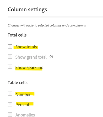

Then finally turn off the values:

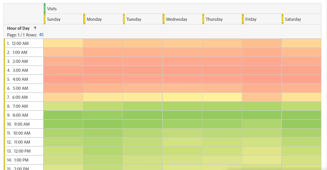

This will create a "heat map" of your traffic high/lows for whatever time frame you select:
So it's not the high and low for each specific day, but creates a nice visual of your traffic times for quick consumption (not so colour blind friendly if that is a concern... it would be nice if we could configure 'high", "low" and "mid" range colours.... )
