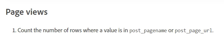

We always used the following to count page views in our warehouse:
sum(case when page_event_Cd = 0 then 1 else 0 end) as PAGEVIEWS
Turns out while all page event 0's are indeed page views they are not the only records which are counted as page views. According to Adobe documentation the correct way to count page views is "Count the number of rows where a value is in post_pagename or post_page_url." With no mention of page event column.
Did some comparisons and sure enough there are plenty of rows in the datafeed that are page event 50 (Media stream start (non-Primetime)) but the post_pagename field is populated. Including these rows our reports from the warehouse are matching to the front end!!
TLDR - If you are using the data feed in a warehouse, you might want to check your calculations to not use page event.

@jennifer_dungan and anyone else that might be following along here....
After exhaustive investigations between myself, my Data Management team and several calls with Adobe folks we have figured it out!
In short we were wrong 😥 More specifically the logic we have been using for 14+ years against the datafeed was incorrect.
