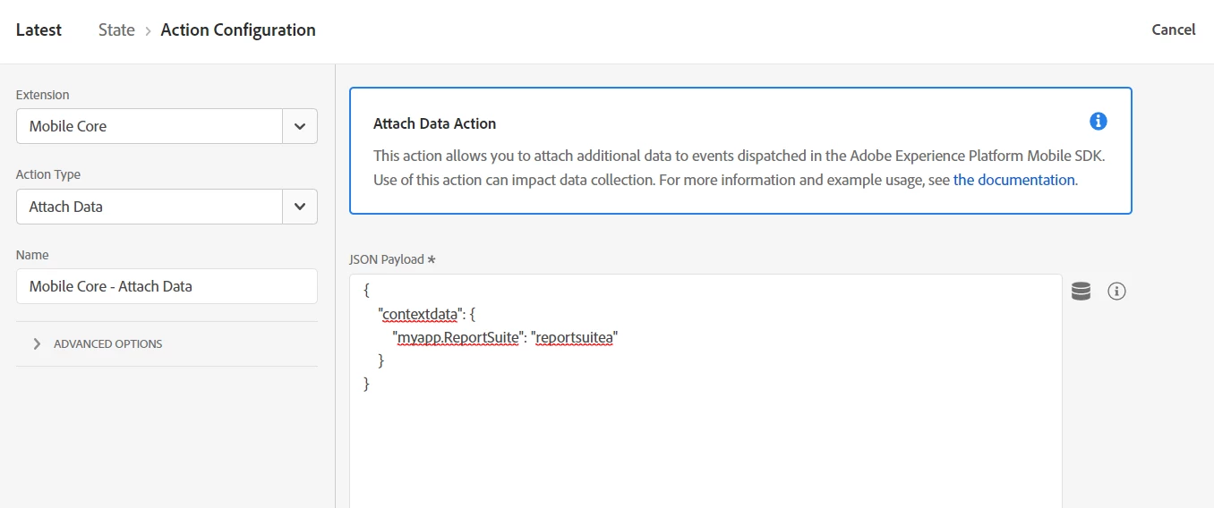

Basically you would use something like:
MobileCore.track(state: "state name", data: ["key": "value"])
Where "key" would be "myapp.ReportSuite" and "value" would be "reportsuitea" or "reportsuiteb", etc
OR you can append it in your Launch like so:
    "contextdata": {
        "myapp.ReportSuite": "reportsuitea"
(set the context variable name "myapp.ReportSuite" to your naming convention, and the value "reportsuitea" to your report suite)

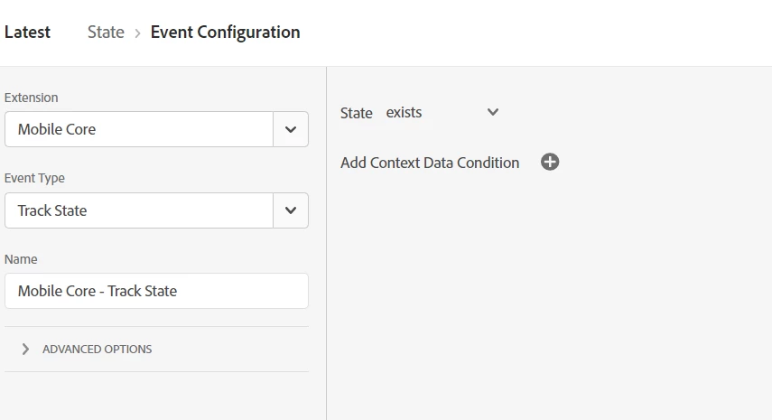

The rule trigger looks like:
Make sure to create a similar rule for actions as well as states, and maybe even for "Launch" events.
This will append your context variable to your server calls, and since the value of the report suite shouldn't be changing (unless you are using one Launch property to drive multiple suites - then this won't work)

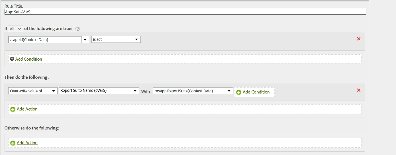

Next, no matter of using processing rule....
In your reportsuite admin, General > Processing Rules
I like to check for app id (to make sure I don't accidentally target web traffic in the suite), you can add multiple conditions, then I choose to "overwrite" eVar5 with my context variable like so:
Make sure you test this first in a QA or Dev suite... processing rules will change the value of your dimensions, so you want to be sure the rules are working correctly before adding to prod... if something breaks there is no way to get the old values back.

how can I set an eVar for mobile app now that we don't have mobile services anymore? is it through launch like a website (after creating the eVar) or via RS using processing rules?
If the eVar is essentially a classification to identity your mobile app... if you only have 1 mobile app, you should be able to set up a simple processing rule like:
(Native apps set a standard context variable with the app id under "a.appid" - so a simple "is this a native app check may be enough"
Then in the "Then do the following" area,
"Overwrite value of"  (select your eVar)  with "Custom Value" (value)
If you have multiple apps, you may need to do a check if this is a native app AND do a secondary check based on the value of a.appid contains, or maybe based on a custom context variable to properly identify multiple apps from one another.
Another recommendation, since you are using Processing Rules, I highly recommend that ALL app rules use the "a.appid" is set check (this will prevent any accidental changing of values coming from your website).  I name all app specific rules with the prefix "App: " to ensure I can tell which rules are which.
    "contextdata": {

I´m now creating the Action inside the rules, and creating the context data like the example you gave me (I just changed the names to post here, I know I've to replace the myapp-prod for the real report suite name)
But this way, even if I'm in the qua report, I would see the prod report suite, correct? Since its an app, how can i code here that would tell conditions, like if it is the staging, the report suite is "myapp-qua", if it is production is "myapp-prod"?
I hope it makes sense!
That is correct... this will pass the prod suite to QA...
Since the Mobile App Launch properties don't allow for custom JS to be written, you can't really create a Data Element that will change the value based on environment.
IF you really need to have the QA suite name passed to QA, and the prod suite name passed to prod, you could create two context variables:
    "contextdata": {
        "myapp.ReportSuiteProd": "myapp-prod",
        "myapp.ReportSuiteQA": "myapp-qa"
Then in your QA Suite, you can set your rule to use "myapp.ReportSuiteQA" in the mapping; and in prod suite use "myapp.ReportSuiteProd" (just make sure you don't copy these rules between your suites!)

1. on report suite I have the evar20: report suite. it's like that for all our products
2. Created a rule:
I ended up only creating the action for our quality environment. if it works I´ll replace the name for the production one:
and my processing rule is this:
However, on workspace the report suite name doesn't show:
all channels is our global report suite, and each one in this is from our websites for the last 7 days.. however, the app is still not showing. I'm starting to believe that the unspecified one is the app as it is the only product we have that we cannot get the report suite yet. all the websites we can.
Any idea what did I do wrong?

I just noticed on another one of your posts that your app is not native.. if so, a.appid won't be set... this is a built in native app context variable... you will need to find another way to identify your app to create a rule around it... I wouldn't want you to override your eVar20 with a null value on your website....
It may have to be as simple as:
If reportsuite (context variable) is set, then overwrite eVar20 with reportsuite (context variable)

And just by curiosity, once looking for the context data I saw this option,
what info does it collect?
