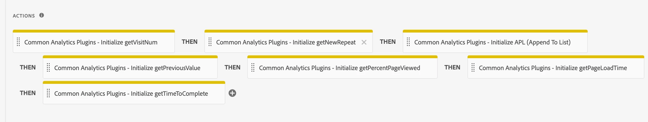

I have initialized the plugin also like this :

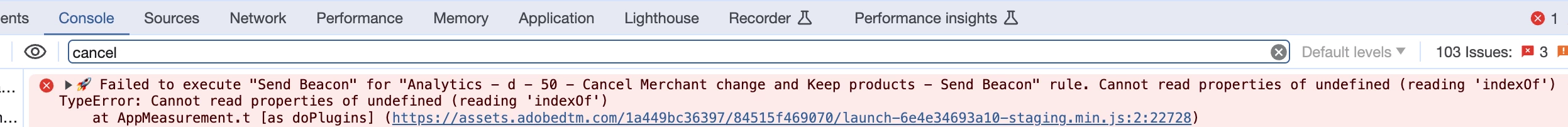

But I'm getting this console error :
is there anything I'm doing it wrong?

Please confirm if you have properly installed the plug-in using AppMeasurement.js after the Analytics tracking object is instantiated
yes I have installed it now as mentioned in help doc https://experienceleague.adobe.com/en/docs/analytics/implementation/vars/plugins/gettimetocomplete and now it is workign corectly
Hi @ambikaTewari_ATCI , it seems like s.events is undefined. Can you check if s.events exists before calling indexOf function?
Hi @AbhilashSh @ezhil_raja
I have used this condition also in extension :
But still I'm getting this error in console :
