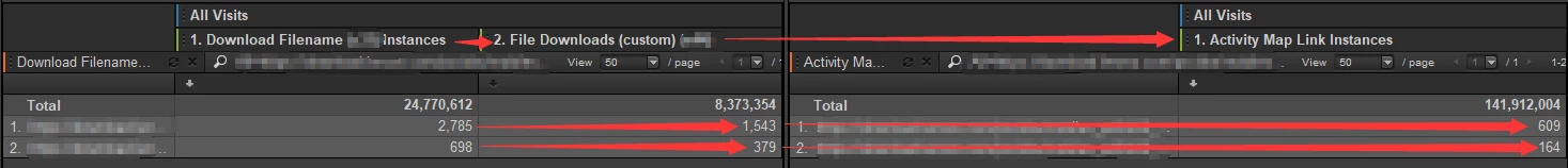

Good day everyone,
May I have your help to clarify the right way to measure File Download?
I can see 3 ways:
1. Activity Map Link with Activity Map Link Instances
2. Dimension Download Filename:
     i. use "Download Filename Instances"
     ii. use "File Downloads" - our custom defined event
As you can see, they are giving significant different result.
May I know which is the right one? and Why they are so different?
Thank You.
H
Best answer by PratheepArunRaj
Dear H_L,
Great to see you too!
Ideally if you didn't have any amendments for the events, then 'Download Filename Instances' should be equal to the 'Custom Event'. If you use some amendments like getValOnce, Event Serialization etc., you will see that the numbers are less than Instances(Which will fire every time).
Check whether Custom Event is firing every time you are downloading the a file.
Thank You!

Hi Karandeeps51149841,
Thanks for your reply, may I know following question first:
Why there are big differences between the counts of "Download Filename Instances" and "File Downloads (Custom)"?
Which one I should use as the "right" one for getting the times of a document is downloaded?

H_LAuthor
Level 7
April 29, 2019
Hi Arun,
Nice to see you again.
The is the custom event for File Downloads.
So I supposed to use this as the right metic, but it was found a big difference with "download filename instances".
So I asked this question.
Would you please try to clarify?
Thank you.
H
PratheepArunRaj
PratheepArunRajCommunity Advisor and Adobe ChampionAccepted solution
April 29, 2019
Dear H_L,
Thank You!
Arun
