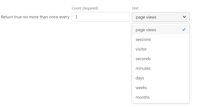

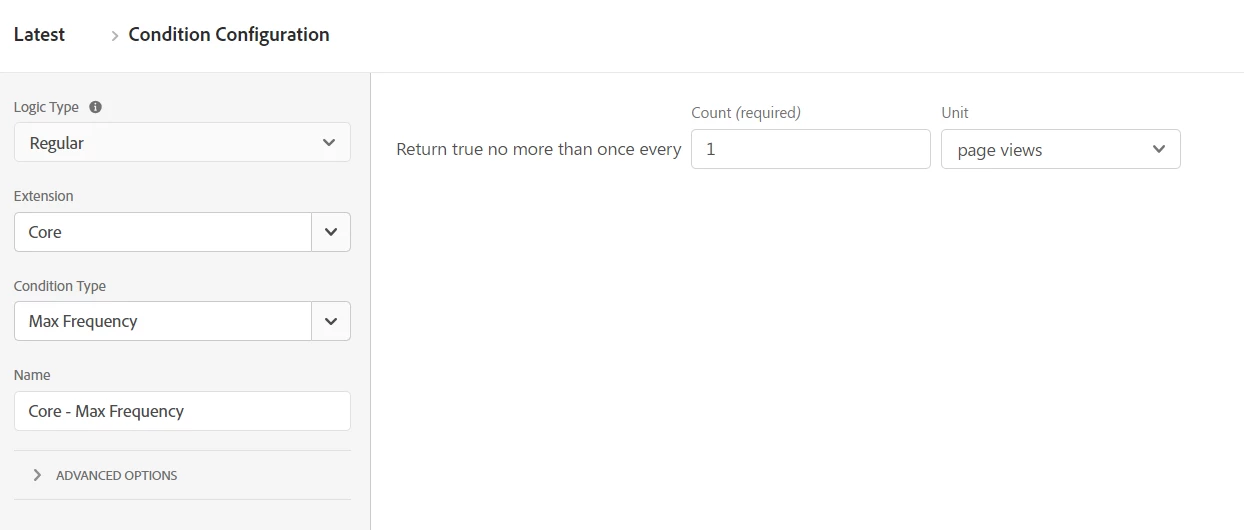

You can also apply a condition to your click rule:
Here is a sample for 1 click per page view:
But you have many options, such as per session or user, etc:
Now this will prevent tracking for any additional clicks... but if you are just trying to distinguish the first click from other clicks....
You could always use the cookie option as suggested by Yuhuisg.
How are you planning on using this? It's also possible you may be able to create a segment in your existing data without changing how your data is collected?
August 3, 2023
@jennifer_dungan @yuhuisg Thank you !! Yes, Trying to distinguish the first click from other clicks. Works fine.
