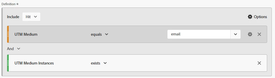

Would using the evar instance metric be a solution to isole hits where an evar was set? (hit container where evarXYZ instances exists)
This is exactly right! There are two ways to do this... you can leverage the Instance Metric directly:

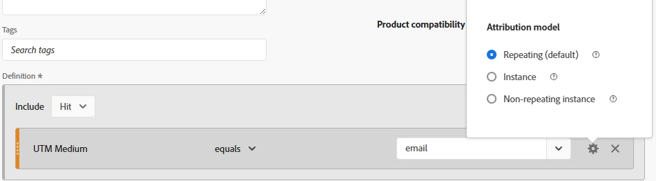

Or, you can use the gear on your eVar to set behaviours:
Repeating is the default, this means it will return all the hits where the eVar equals the value (whether explicitly set, or persisted)
Instance will only return the hits where the value was explicitly set (i.e. eVar10="x")
Non-Repeating Instance is interesting, it will return the instances of where the value was set, unless the same value was set in a row, it will exclude the repeats.... for example:

Isn't strictly true... you don't have a custom event being set, but every time an eVar is set, there is a standard Adobe event for that eVar that is also triggered... this is called the eVar Instance metric. So if your eVar10 is called "Filter Option" then the corresponding metric will be called "Filter Option Instances".
Using the same scenario above, here is where those events will be included:
