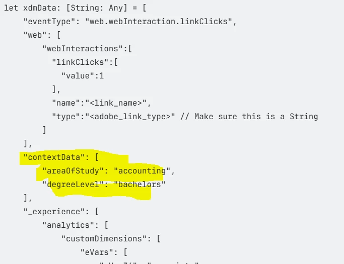

  • In addition to the structure mentioned above, we asked the dev team to sent the below and this doesn't work when I map it in the datastream to props and eVars.
    • "contextData": [ "areaOfStudy": "accounting", "degreeLevel": "bachelors" ],

  • You should be able to use those context data values to map to eVars/props/events in Analytics via processing rules; indeed, as I understand it, one of the main use cases is to send all data as context data, so multiple sources can use it without needing standard field grouping: so Target can read the context data, analytics can use it via processing rules, etc.

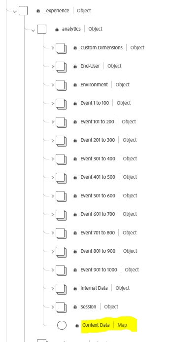

Regarding context data, do you know if we can just have context data at the same level as experience? Below is what I have from the devs.
Or do you think the values should be inside of the context data field under _experience? Here is the context data field i found

If you want them to automatically be treated as context data, I would think they need to be sent into the proper field... if you are mapping data (which you seem to be having issues with already) then you probably don't need "context data" but can map any custom field (again assuming you can get it working).
I've never mapped DataStream values to Adobe, I've just sent data to standard fields in the Analytics model (or the standard XDM fields)

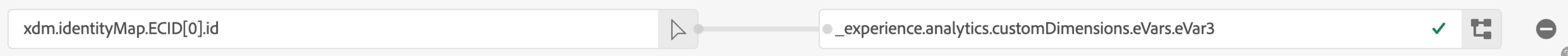

For the mapping part of your your speaking XDM field, have you tried something like this in your datastream?
_mycompany.shoolName -> _experience.analytics.customDimensions.eVars.eVarX
like in the example below, where I map the implicitly added ECID to eVar3.

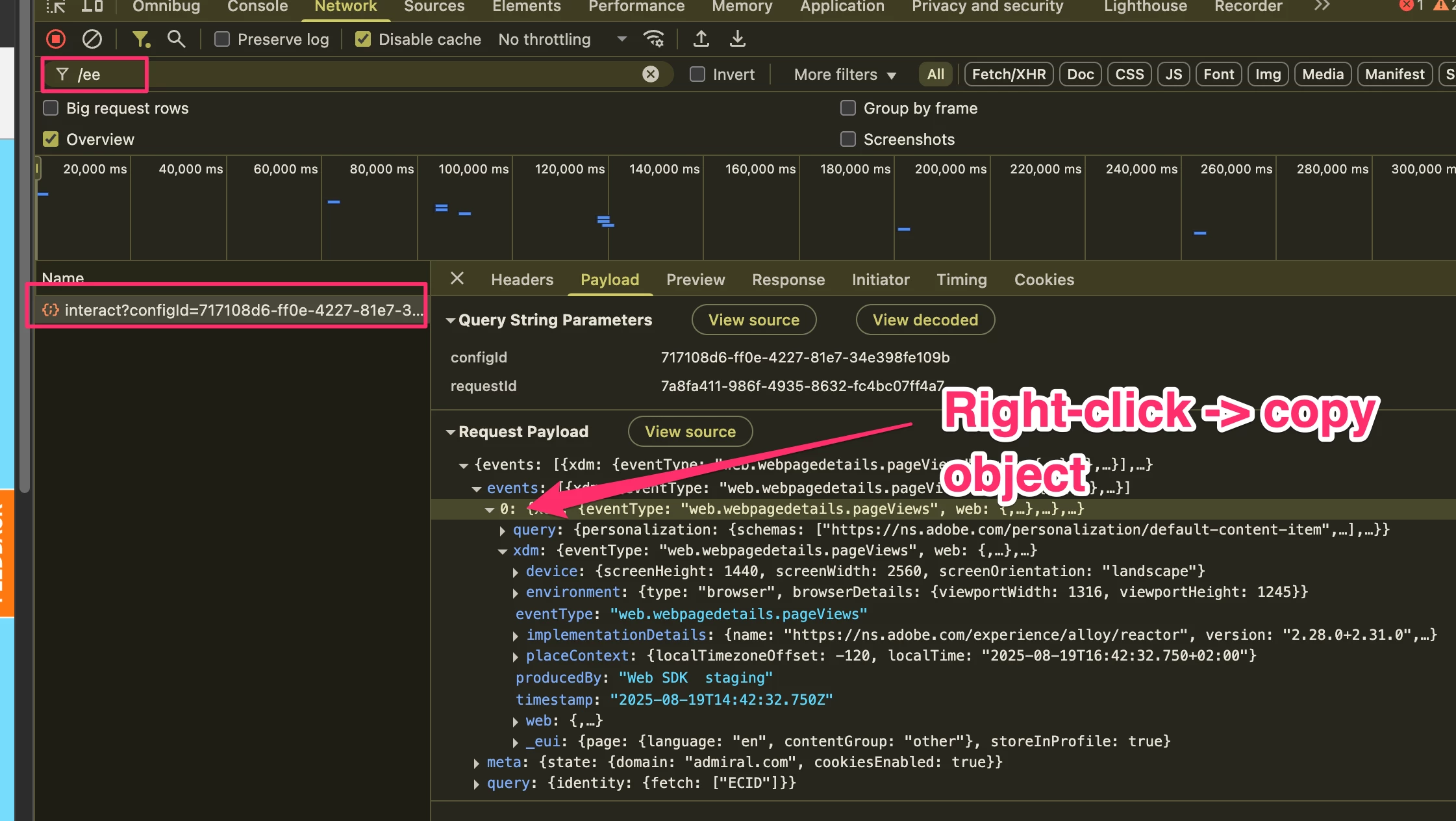

I would do it this way:
  • open your website and developer tools (F11)
  • filter for "/ee" requests
  • open the request payload and right-click on the first item in the "events" property
  • click "copy object"

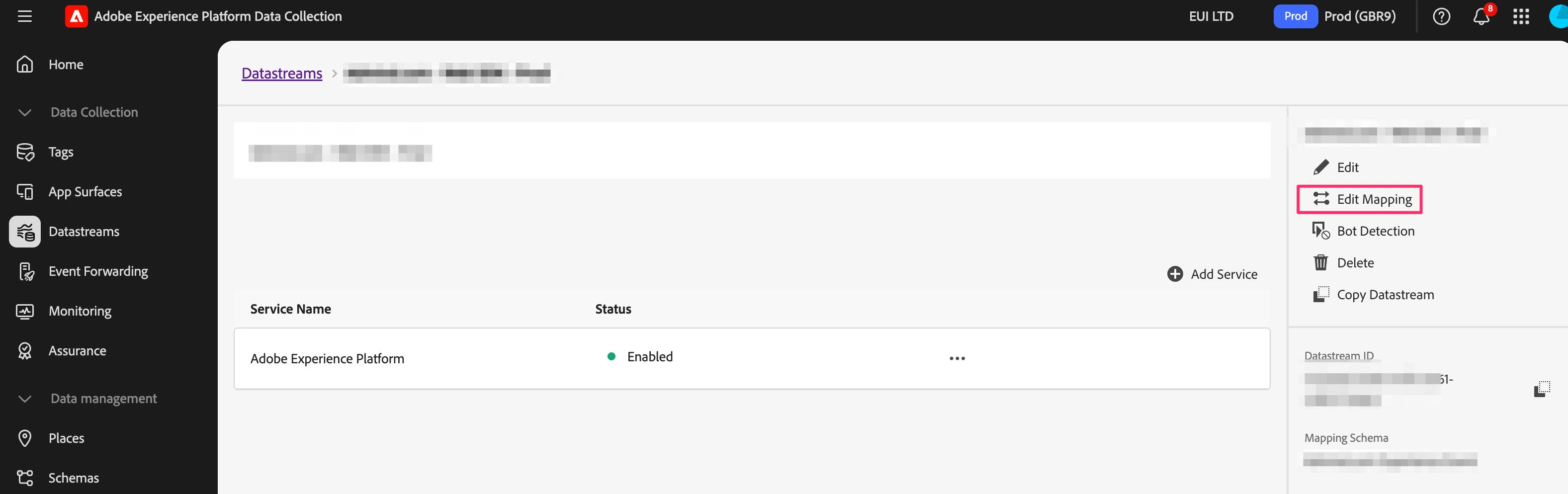

  • open your datastream's mapping
  • paste the JSON from your clipboard
from there on, you can use the arrow icon to locate the source field you want to map.
And for the analytics fields, use the pattern as mentioned above "_experience.analytics..."

@bertbru  This should be correct for first question, ignore my reply. I tried this on one of my datastreams & despite Adobe erroring for the first 30mins or so it eventually pulled in the correct data- although bear in mind I mapped a pre-defined field to a custom field I created, not vice versa, just in case that is the issue.
