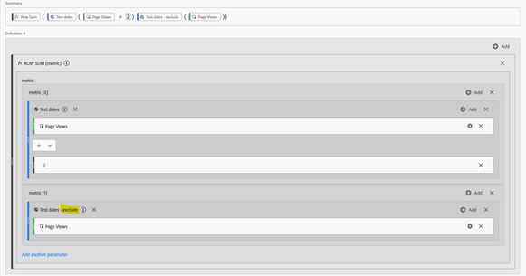

It is quite challenging to handle such scenarios directly within Workspace.
Recently, I encountered a similar issue in my application—though in my case, pageviews were being inflated due to a different bug, not just duplicate calls.
Normalising duplicate page view calls can be achieved in Workspace using workarounds and assumptions. However, for this to be reliable, we need to be 100% certain that the duplicate pageviews occurred consistently for all users within a known date range. Only then is it reasonably safe to divide the pageviews for the affected page(s) by 2.
In essence, the approach I used was similar to this SQL-style logic:
ROW_SUM(ADJ_PAGEVIEW_1, ADJ_PAGEVIEW_2)
  • ADJ_PAGEVIEW_1: Pageviews divided by 2 to account for the duplication on the specific page(s).
  • ADJ_PAGEVIEW_2: Actual pageview count, excluding the affected page(s) during the impacted time period.
By combining segments and calculated metrics creatively, I was able to approximate a more accurate trend.

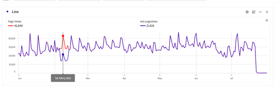

Example:
I tested the approach by adjusting the pageviews with a factor of 0.5 (i.e., halving them), and it seems to be working as expected in my case.
This workaround helps in analyzing trends and reporting only when the duplicate behavior is uniform and predictable. If the duplication varies—say, some users get 2 duplicate calls while others get 3 or more—then this approach will not yield accurate numbers.
Screenshot:

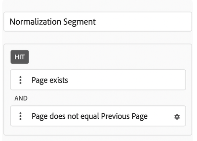

Hi @kayzee ,
Adobe Analytics doesn’t offer a built-in way to directly compare the current page to the previous page across all hits unless you explicitly captured the previous page using getPreviousValue() in your implementation.
Implementation Options
Option A: Best Practice (with getPreviousValue)
Precondition: You have implemented getPreviousValue() and stored the previous page in an eVar or prop (e.g., eVar15 = previousPage).
Then your segment can be built like this:
In Segment Builder:
  • Container: Hit
  • Logic:
    • Page exists
    • Page does not equal eVar15 (your "previous page" variable)
Limit to Time Period:
Instead of putting "time.period = date" inside the segment, do this:
  • When you apply the segment in Workspace, filter the panel to your target date range (e.g., Jan 1–31, 2024).
  • Don’t hard-code date into the segment, so it's reusable.
Option B: Without Previous Page = Not Feasible for All Pages
If you don’t have a previous page variable captured, Adobe does not let you compare the current and previous hit directly (unlike SQL or CJA).
You might try a Sequential Segment, but it becomes page-specific. Example:
Hit 1: Page = “X”
THEN within same visit
Hit 2: Page = “X” → this is duplicate
So you could build a Sequential Segment like:
  • Step 1: Page equals X
  • THEN within 1 hit
  • Step 2: Page equals X again
But this would have to be built for every page separately — not scalable.
Recommendations:
If you already have a previous page variable (e.g., eVar15):
Use this segment logic:
Container: HIT
AND
Page exists
AND
Screenshot :
And apply the time period in the Workspace panel when pulling data
If Not Implemented Yet: Quick Fix for Future
Ask your dev team to implement getPreviousValue():
s.eVar15 = getPreviousValue(s.pageName, 'gpv_pn');
It uses Adobe's append-to-cookie pattern to store the previous value per session.
Screenshot of segment:
Thanks.
