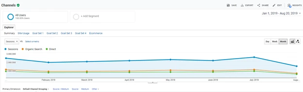

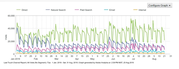

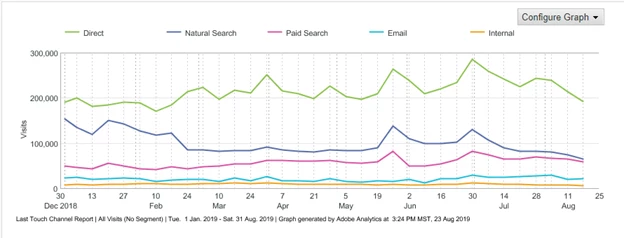

For some reason we saw a large divergence in our direct vs natural channels on February 22 according to Adobe. We have checked all release notes and tags to see if anything may have been changed to create this divergence and have found nothing. Also when viewing channels using Google analytics we see there are no changes in the trending of direct vs organic. I realize raw numbers will not match between Adobe & Google but trending should if users truly were coming directly vs searching. So to me this points to a setting in Adobe that must have changed.
Last Touch Report Jan 1 2019 - August 21, 2019
vs GA

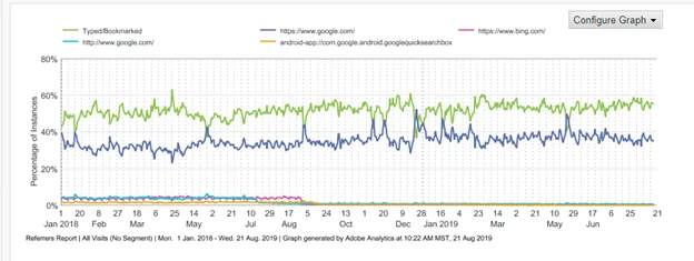

The other curious thing is the referrer report, you can see Google vs Direct maintains a consistent trend, but this report uses instances (not visits) and I assume referrer=google.com would include paid and organic.

If I understood it correctly, the first screenshot is showing Marketing Channels. If it's the case, the issue is likely in the Marketing Channels Processing Rules. You may want to review them and also investigate what was updated in the report suite on 22-Feb (Admin > Logs).

If the cause was with the Paid Search detection, the trend chart would display changes for Paid and Natural, rather than for Paid and Direct.

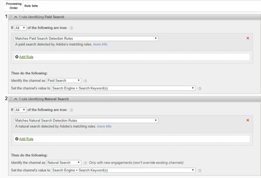

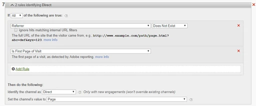

Could you share (or send a direct message with) a screenshot of Processing Rules and the first chart but with Y axis in absolute numbers (the numbers themselves can be obfuscated if necessary)?
e30powarAuthor
August 23, 2019

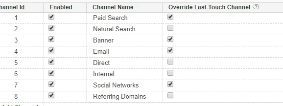

Thank you for the reply. I'm pretty sure the rules are defaulted so no problem displaying here.
And here is the last touch report in numbers by day
and by week

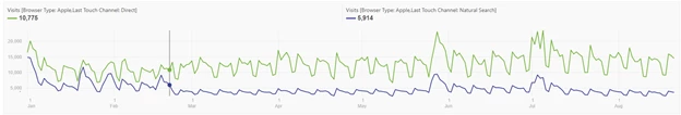

This is interesting and hard to tell if there is an issue because the majority of our traffic is from chrome or safari, so you'll see both have a divergence in the last touch channel.
Browser Type = Apple
Browser Type = Google
