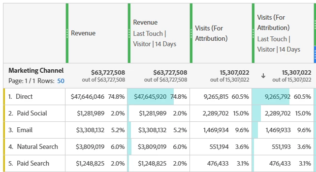

One of our business units has their marketing channels set up with Direct Load as a channel and with it checked to Override Last Touch Channel.
I know this goes against Adobe's best practices, but what are the implications of having it set up this way? What does this do to your data?
Some in the business believe that it simply prevents the next session from getting attributed to another channel when its a Direct entry, but I would assume just using default attribution metrics would do this. So are we actually doing something else or more when we have Direct checked to Override Last-Touch Channel?
Best answer by FarazHusain
I totally understand your examples, but I'm not really talking about first or last touch attribution. I'm talking about the default dimension with no attribution. My question is what I would expect in the same session (non attributed) metrics. If hit 1 is Affiliate, but hit 3 is Direct, and I have override checked, should my same session (non attributed) channel be Direct or Affiliate?
As you can see in my earlier image, it seems like it overrode hit 1 to say Direct even though at the time hit 1 was Affiliate. So I really want some official confirmation of how that works. The link on the ? mark sends you to a dead web page so that's no help.
Somewhat related, it does seem that this setting causes last click attribution to die. Our non-attributed metrics essentially match any and every last touch attribution model rendering them useless for additional analysis.
And I've attached this report suite's direct rules (at the bottom of the processing rules list).
Hey @JayGr, The default ‘Marketing channel’ dimension functions identically to the ‘Last touch channel’ dimension only, so in a way, you are looking at the Last Touch Channel report. Yes, if hit 1 is Affiliate, but hit 3 is Direct, and you have override checked, in the same session channel would be overridden to direct. We can take a more deeper look of your setup and report, if you can log a support ticket to and we can cross validate this with the backend data as well and share more detailed analysis.

Hi Faraz,
Thank you. I've read this example already. But ours is the reverse as the image (having Direct checked) so that's why I wanted more specific clarification.
So for example, let's say I started a visit with an Affiliate, added an item to my cart, opened a new tab and entered the site directly and purchased, then my order would be credited to Direct Load and not Affiliate?
And then what does it mean by "override"? Should I still see my first hit credited to Direct Load, or should the data say my first hit was credited to Direct Load?
I'm trying to get clarification because the latter is what looks like happens when I test it myself. In this example, I entered on a link from Rakuten on the Home Page, and then opened a new tab with a link to our Program Guide. But I want to know this is expected Adobe behavior when I've got this checked and not just a random glitch during my test session.
And what about my next visit? If I enter via Direct, using default attribution metrics, wouldn't that still say Direct even if I didn't have Override checked? That's the primary reason the business wants this checked.
