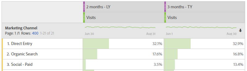

I have a table of visits split by channel. I have turned off numbers so that I can just see each channel as a % share of the total - I have this for TY and LY and am wanting to create a new column that will tell me the difference between the two percentages.
When calculating as a percentage change, or as one minus the other I am getting stupid numbers. Using a Summary Change Visualisation with Raw Difference gives me the right number but I can't seem to replicate in my table.
Anybody experienced/solved this before?
Current set up of Freeform Table:

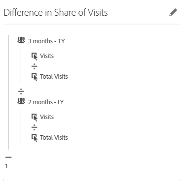

Try this formula in calculated metric builder = TY[ Visits/TotalVisits ] / LY[ Visits/TotalVisits ] -1

Got this now - thank you! However, the numbers still don't seem to make sense with the formula above?
Set up of Difference in Share of Visits:

Andrey_Osadchuk
September 9, 2019
Lindsay,
2.55% shows by how much 32.88% is higher than 32.06%. Is not it what you were looking for?
lashworthAuthor
September 9, 2019
Apologies, I didn't realise I had said percentage not percentage point - however I've now managed to work out how to adjust it. Thank you so much for your help!
