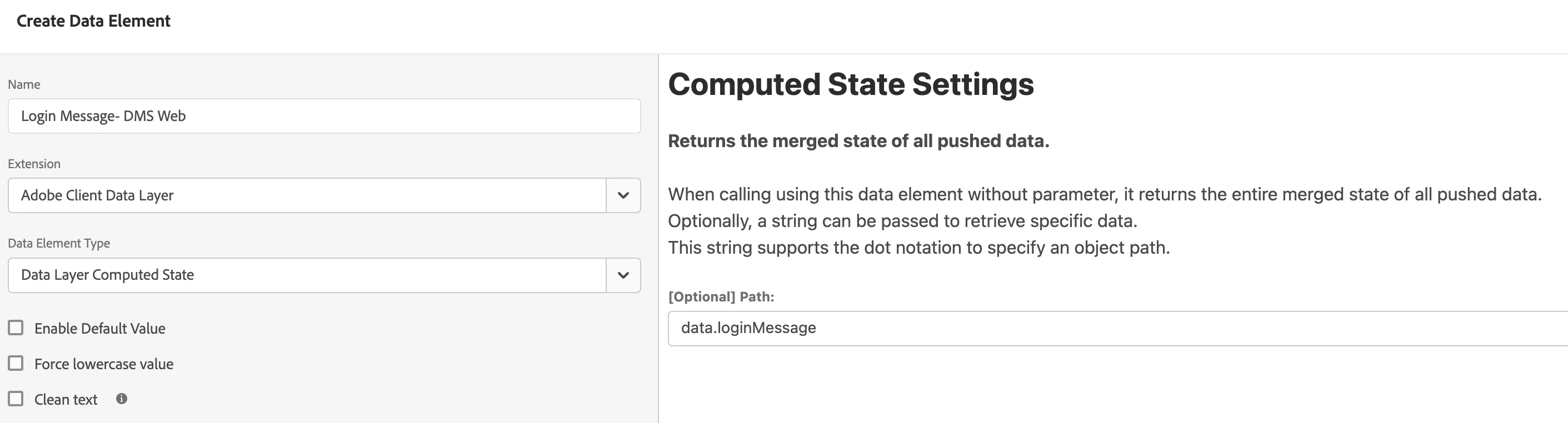

I am configuring analytics web SDK setup for one website where ACDL is implemented. In the console, I can see the data layer values populating in the data layer. However, the values are coming as 'null' when sending Web SDK events.

Hi @firefighteradi
in addition to what @jennifer_dungan wrote, it's maybe worthwhile testing this in your console.
adobeDataLayer.getState("data.loginMessage")
Should there have been any other previous push to the data layer, your access to index 0 will obviously not work.
However, since you do not seem to use an eventInfo subobject, the pushed data is aggregated into the so-called computed state (whereas anything pushed into an eventInfo sub-object would only be processable during this specific ACDL push event).
// push to computed state adobeDataLayer.push({ data: { loginMessage: "foo", } }); // read from computed state adobeDataLayer.getState("data.loginMessage"); // returns "foo"
Should this work, I would suggest to change your data element "Login Message- DMS Web" from type "Javascript Variable" to the "Adobe Client Data Layer" extension's "Data Layer Computed State" type with "path.loginMessage" as path value.
Maybe check out Andy Lunsford's Adobe Client Data Layer's cheat sheet to get a better understanding.
Cheers
Björn

April 16, 2024
Thanks for your reply.
I am populating the schema through data element.
and then sending the event through rule.
