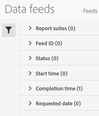

Hi, I am trying to create a data feed that would fetch data from the 1st December to 1st of January. This was configured to fetch daily. The status has remain active for hours. How do I check what is wrong and why it hasn't completed the job in the past 5 hrs. I checked job history, I found nothing

Go to the 'Jobs' tab

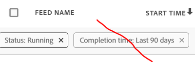

There, make sure that the 'completion time' selection is turned off - because or else you will only see what's completed. I would select 'status' = running and turn off 'completion time...' which is actually there by default
You can also play with other status selections to find your Job
