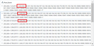

    or post_event_list_text like '1,%'
    or post_event_list_text like '%,1'
Thanks @leocwlau , I tried it, dint got any output. However if you see below screen shot,  ",1," ",202," are appearing at the begging of the event list...  I just want to recite my query again here...  trying to build visit level segment having event3, Order event & v13 in the post_v13 because v13 is firing on Home page then on order conf page e3 & order events are firing.

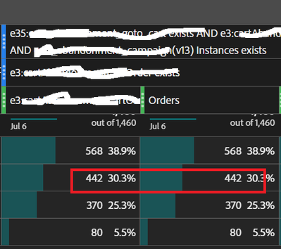

Resharing my SQL statement for better understanding:
SELECT
SUM(CASE WHEN (Post_Event_List_Text LIKE '%,202,%' AND Post_Event_List_Text LIKE '%,1,%' AND Post_cart_abandonment_campaign_eVar13 ='Cart Abandonment campaign') THEN 1 ELSE 0 END) as e3
FROM
    table-name
WHERE -- Segmenting the visit
    (Post_Vis_High_Identifier,
    Post_Vis_Low_Identifier,
    Visit_Number,
    Visit_Start_Gmt_Timestamp  -- hoping something needs to be added here
IN(
   Select
   DISTINCT Post_Vis_High_Identifier,
    Visit_Number,
    FROM  table-name
WHERE
    Exclude_Hit_Number = 0
    AND Hit_Source_Identifier = 1
    AND Duplicate_Purchase_Flag = 0
    AND year(Visited_Timestamp) = 2024
    AND month(Visited_Timestamp) = 8
  --  AND day(Visited_Timestamp) = 12
    AND (CONCAT(',',Post_Event_List_Text,',') LIKE "%,202,%"
    AND CONCAT(',',Post_Event_List_Text,',') LIKE "%,1,%")
    AND Post_B2bi_Status_Text = FALSE
    AND Post_cart_abandonment_campaign_eVar13 = 'Cart Abandonment campaign'
    AND Order_Identifier IS NOT NULL
    AND Order_Identifier NOT LIKE '1%'
When I run above query, getting e3 = 538,,  however in Adobe WS, I am getting 442
It is always tricky to reproduce the exact results with Data Feed raw data against the AA WS UI, as we need to make sure to have the exact segments/metrics logic.
From the latest screen, I noted the segment name mentioned "(v13) Instances exists" which I don't see in the SQL.
Can you share the screenshot of those segments/metrics definitions with me? Please DM me if there is anything sensitive and you don't want to share publicly.
