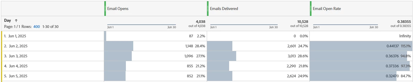

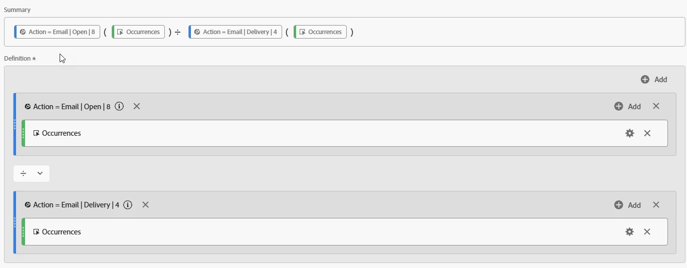

I'm trying to create an Email Open Rate metric and have it as a percentage.  This is what I've done so far but it's just showing it as decimals.  How can I get it to show the decimals as percentages e.g. June 2nd as 44% and not 0.44.  Thanks in advance

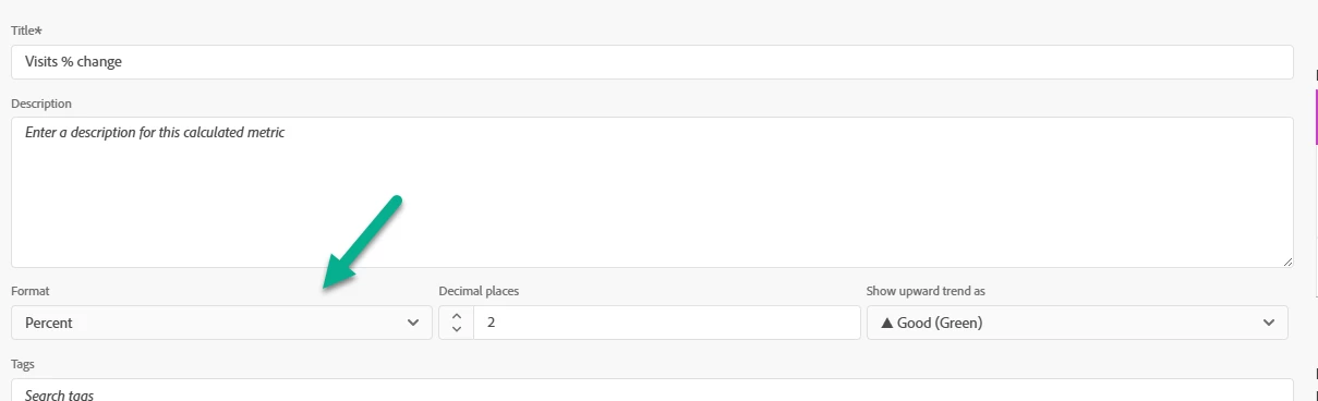

Hi @tthmx9 this is a great question! Near the top of the calculated metric, select the format dropdown and change it to percentage. You can then add additional decimals if you want to show 44.44% for example.

Hi! You can format it to show as a percentage by editing your calculated metric. Just click the gear icon when you're building the metric, and under “Format,” change it from number to “Percent.” You can also choose how many decimal places you want (e.g., 0 for 44%, or 2 decimal places which might result in 44.00%).
You can also see the result in the preview on the right hand side of the calculated metric form -
