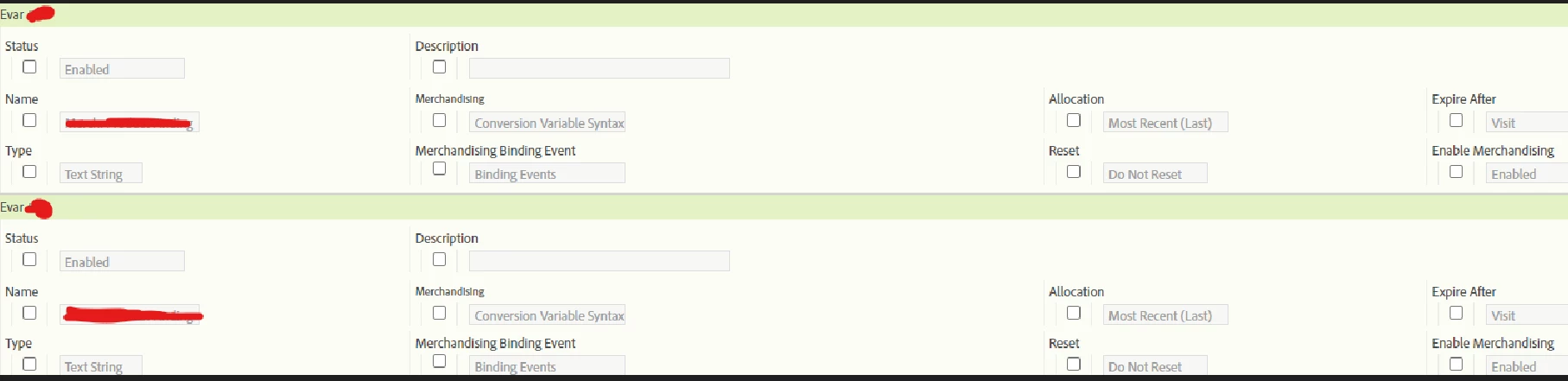

Counter event not showing against product finding method values. Whenever user clicks on drop down filter, click event gets triggered with custom link name "filter click" and  event named "search result filter (event100)" which is basically a counter event and evar which is enabled for product finding method which collects filter value that was clicked.  Now when I try to use search results filter against the evar which collectes filter value I dont see numbers against respective values but seen as unspecified. Whats the issue here?
Yes this is how it is configured.
Ok, so you are using "conversion variable syntax", which according to the documentation:
Conversion Variable Syntax is used when the eVar value is not available to set in the products variable. This scenario typically means that your page has no context of the merchandising channel or finding method. In these cases you set the merchandising variable before you arrive at the product page, and the value persists until the binding event occurs.
When the binding event selected during configuration occurs, the persisted value of the eVar is associated with the product. For example, if prodView is specified as the binding event, the merchandising category is tied to the current product list only at the time the event occurs. Only subsequent binding events can update a merchandising eVar that has already been assigned to a product.

This says to me that the value is set, but is basically just "held" until the binding event is triggered (then it's used).... I've not used "Conversion Syntax" before, I will try and set up a test in a dev environment to test this out.
You can only see the binding event(s) by "editing" that field... check the box, and the dropdown will appear..  but I suspect that this is being bound by a specific event, and thus when the values are set, this context is not part of the binding.

Without seeing your implementation this could be hard to diagnose... but it looks like the event and the dimension are being captured on different tracking requests based on the behaviour in your report....
It's almost as if the event is being captured when the filter drop down is clicked, but then the selected filter is being tracked either when the specific filter is selected (or maybe on the page view after the results are filtered)....
