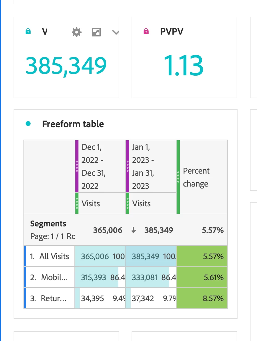

When you say you were changing the filters and date ranges, were you referring to those (blue) segments and (purple) date ranges? If so, then those segments and date ranges are defined at your user level, not at the project/dashboard level. (Well, segments can be defined at the project/dashboard level too, but that's not commonly done.)
Since these segments and date ranges are defined at the user level, then they are shared resources within all of the projects/dashboards that use them. So yes, when you update them in a specific project/dashboard, then AA applies them to all other projects/dashboards where they are used (including projects/dashboards that other users have created but have included your segments/date ranges).
The solution is to not only have copies of your project/dashboard, but to also copy the corresponding (blue) segments and (purple) date ranges ... and also (green) metrics if you have created your own calculated metrics.

The filters I am changing are just the free form data column filters.  I need to use those so I can use the % change column they give you when using the compare time periods within the free form tables.
So you're saying I'd have to copy all my segments and metrics separately from the project itself? IE i'd have to have a monthly copy of each segment?
As far as copying the purple filters - I don't think this is possible is it? These are just applied to the table themselves and I didn't think were stored out?
If you're changing the freeform table filters, then those shouldn't have been applied to other projects. If that's happening to you, then that sounds like a major bug that needs to be raised with Customer Care promptly.
It's quite unusual for (blue) segments to be defined differently month-on-month, unless you have a date condition in your segment. If you do have a date condition, then I would suggest removing that date condition into its own (purple) date range, and combine that date range with your segment in your report.
To see if you're really using your own user-level (purple) date ranges, in the very top menu in AA's interface, go to Components > Date Ranges, then see if your date ranges are there. If you see them there, then you are, indeed, using your own user-level date ranges in your projects/dashboards.

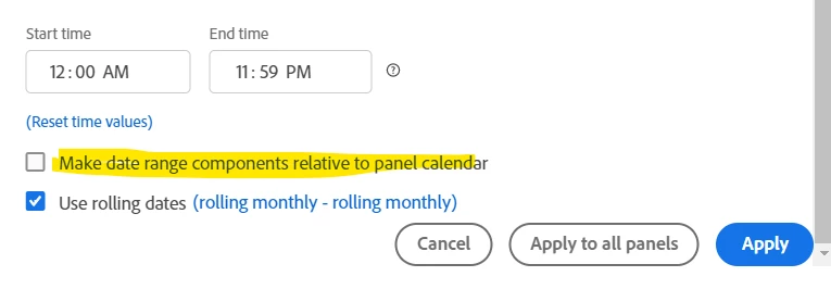

That said, in your example, since your edits were just around making variations for previous months... have you considered just changing up your report slightly and using the new "Make date range components relative to panel calendar" feature?
If you build this out, all you have to do to see the comparison between Dec and Jan, or between Nov and Dec, etc would be to choose "Dec" in the calendar for the panel... and let the columns load "this month" and "previous month" based on "Dec"?

That said, your recommendation is fantastic and I was planning to implement a more "dynamic" option that would like all the filtering back to the panel filter but was waiting to when I had more time but Adobe seems to have forced my hand on this one.
Per your recommendation - would I still be able to use the free form table % change metric that is added when you add a data range comparison in the table?
