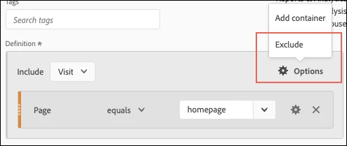

You make it an "exclude" segment by selecting the option highlighted below. (This is the only difference between your two segments.):
Once selected, the definition will display the following. Note that it now says "exclude" and the left border is red:
