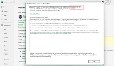

1. Download the correct version by verify your Excel version by going to File > Account > About Excel. Your excel might have updated so it wont support the 32 bit, My excel version support 64 bit, refer the below screen,

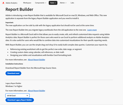

2. If the 1st point is good, re-install the report builder by downloading the new file from the below screen shot location,
