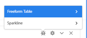

 A little known fact about building API 2.0 calls, is that you can get the API calls used to build your Workspaces using the Debug mode, then you can tweak the API calls if needed.
First enable Debug mode:
This will add a new icon to your freeform tables:
When you click on this, it will have a popup asking if you want to get the call for the freeform or the sparkline.. choose freeform table:
Now you will be presented with times for each API call:
When you select the time(s), it will open a new window that will show the API call in multiple formats including JSON and CURL, etc.
Maybe this will have better luck getting the Total Time Spent? Or maybe that metric truly isn't available this way? I don't use the Time Metrics in Adobe...

That's exactly what I was trying to grab report request from UI. Total Time Spent has the same id I try to use in my report request. Obviously, warehouse type of report within API 1.4 doesn't support this metric. I decided to keep using my report with source=standard.
