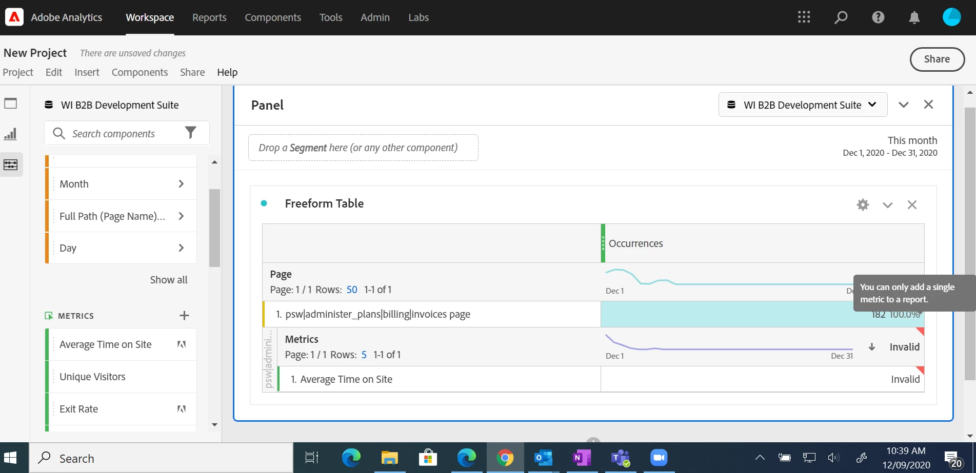

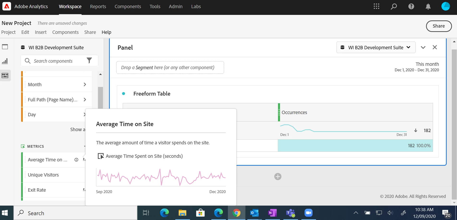

Hi, I'm new to Adobe Analytics and I'm trying to build a Freeform Table in Workspace. So far I have designated my report suite and added the correct page to my table. However, when I try to add a metric to my page, it's marked 'Invalid' and says 'you can only add a single metric to a report.' I'm confused by this because it is only a single metric and when I click the 'i' in the actual metric in the left-side of the screen, there is a linear visualization of the data, so I know the data exists. Can anyone help me understand where I am messing up in building this table?

Can you show screenshots of which part of the Freeform Table that you're trying to add your metric(s)?
@yuhuisg here are the screenshots. This same behavior happens for every metric. Adding segments, however, does not give invalid results. Screenshot (2).pngScreenshot (1).png
You've already added the (green) metric "Average Time on Site" as a breakdown row.
Did you perhaps want to use one of the Time-related (yellow) dimensions in your breakdown instead?
